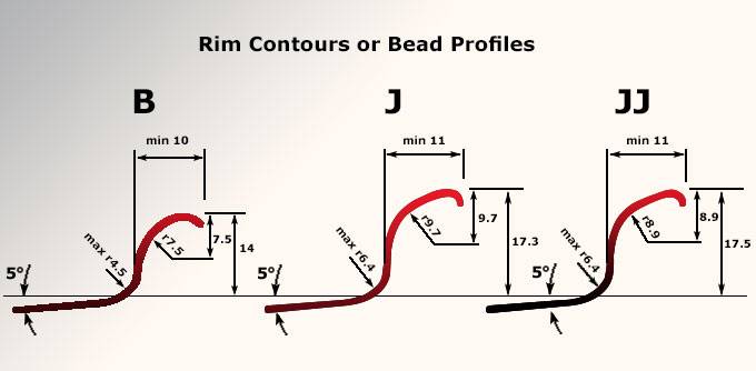

What are JJ wheels?

15x7 steelie's on Formal station wagons and cars with towing packages.

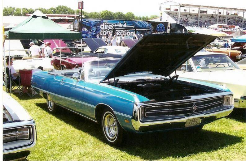

There's an older guy here with a few very nice formals, knows them inside and out. He has some wider road wheels like these on at least one of his cars.

I remember seeing a chart years back on what the letter codes meant on wheels, but I can't find one now. What does JJ mean? Is it a reference to a load range, like letters on sidewalls, or flange type, or something else?

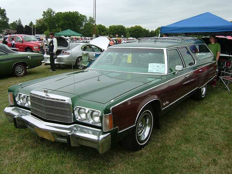

The road wheel was available in 15x7 from 78 (the first iteration was the NYB Salon wheel..it's a road wheel hiding behind the aluminum fascia) through to the end of production in 1981. It seems that 1978 was an odd year and that the chrome road wheels were 15x6 and only the Salon wheel was 15x7 in 78 and then from1979 on all road wheels were 15x7 until 1981.
I can't prove that with factory information (all the data books talk about the forged aluminum wheels and omit the steel road wheel entirely), only personal experience. The 15x7s are fairly rare because of all the aluminum wheel hype of the 80's so I guess few were ordered that way.
The set on my T&C came from an 80's LeBaron M Body. Here's a pic of a 79 LeBaron from the brochure with the 15x7s.
