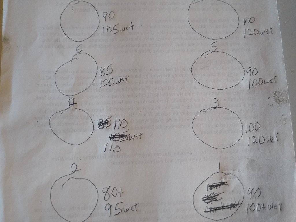

I haven't done a leak down test because I didn't want to spend the $ yet. I did another compression test DRY then WET and here are the results. Can someone tell me what the numbers mean as this engine has about 1000 miles on it? It looks like a leak down test is next. The vibration is really throwing me. Can carbueration cause that?
