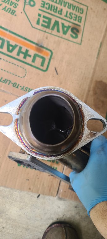

.....something off about that? Haha I must have tightened this too hard. The gasked on the head showed no signs of being blown but gets replaced anyway. Guess I have to figure out how to really seal that now...
The conical donut should be what seals the joint, not that bead on the outside?
Yep its like a ...ballflange sort of. But it had a nice line all around and did not look like it showed signs of a leak. I managed to round it back out as best as I could with lots of heat and a big socket. Made some studs for the holes that go into the waterjacket and supposedly the gasked are gonna be here tomorrow so we shall see how it goes
Well... it is not the manifold gasket. The balljoint is sealed, the header is sealed against the head as well. I did inspect it when I had the header out and did not see any shady welds or gaps on the inside where the tubes meet. But I have found that leak.
I had half a jbweld steel stick that i ramrodded into there. Ot gor better already but I think i need the high heat stuff lol the epoxy is smoking pretty good
If you did take it back off, I would bet you will see a hole or crack from the ball flange side
Oh this isnt coming back out haha. If anything i will crawl under and take the collector off to see if I can reach the inside with my welder.
I do have to say... I paid 110$ for those headers and I really didnt expect them to be perfect. Leaking lime this however I did not expect. Otherwise they really dropped right in.
