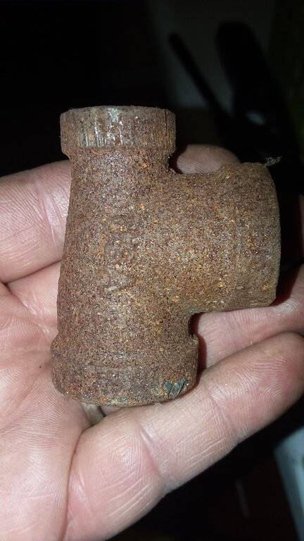

Don’t do it . Get later made water pump housing with the extra holes you need or install a threaded nipple and a tee in your heater hose hole then your hose nipple into the top of the tee. Mount the sending unit into the side of the tee . Drilling through thin cast and tapping it is a recipe for disaster down the road even if it works. it’s a weak spot and it will crack .

I don’t have any pictures of the set up but it’s a low cost alternative to what you want to do.

This is the type of tee I had installed at one point in time.
