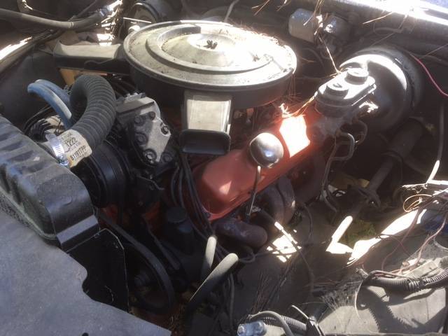

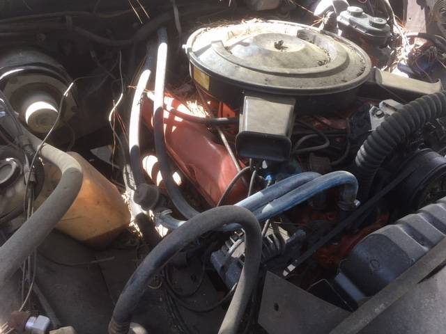

I do think the welds are sloppy. As for balance I've seen shops build driveshafts before & not need weight. Maybe that's why the welds look sloppy. He built them up while balancing. I called him back & he ask me to try it. Said if I won't happy he would make it right. He seemed like a genuine cool guy in all my dealings. He rebuilds fluid pumps, Hydraulic cylinders ,pressure valves, large fluid pressure hose & driveshafts. It's the real deal. His shop was packed with trucks & machinery. I think he got in a hurry. Only reason I used him is my neighbor has used him & told me about him. As for the u joints. Yea it's a 440, but Stock motor home engine except headers. I think NAPA u joints will be fine. I stuck the drive shaft back in before replacing that front joint at the request of the shop. I'm going to drive the truck around a bit & see how the shaft does. If all is ok I'll pull it back out & replace the joint. I don't know if I ever posted a pic of the engine. It looks right at home. It's a little dirty. Work in progress. It does have a 3.91 sure grip. It's a short bed too so it ought to be a pretty fun truck to play with. I need a shop truck. My other truck I'd like to keep clean & use for hauling the race car.
