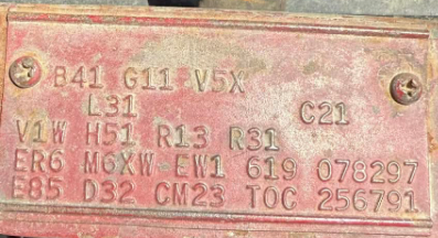

Show us the tag. Does it have a painted roof ?

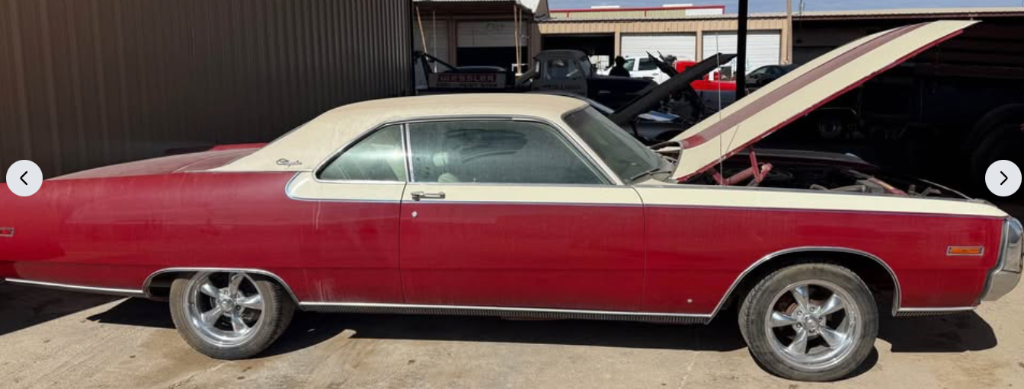

Should have posted this previously so you all could correct my decoding skills with the various online tools. White interior, white vinyl top, white Hurst-like stripes. Apologize for the previous confusion, both colors seem to be original but unknown if it was painted later to copy the Hurst.

Your car had a ER6 red body, V1W full white vinyl top.
The EW1 is white upper door frame paint.
The "hurst" white hood treatment and upper body paint has been added. It just follows body lines so it's an easy thing to do. Looks good on there and goes well with white interior.

That has to be a repaint. Chrysler never offered that paint scheme.
The red does match the ER6 code. The EW1 code would be for the painted interior doors, M6XW is the white interior.

That EW1 for the interior doors was my screw up. Thanks all. I thought it was a good look also. This is a running driving car but it does need headliner and a head to toe going over and wanted to get my facts together before driving 3hrs to see it.
Yes must go and look it over. Nice it's a 440. Good looking car and in decent shape. Could clean that one up.
Needs a different whee/tire look
