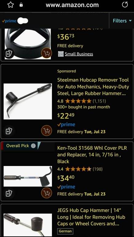

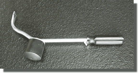

Nice but hard to find. I haven't seen one for sale in a very long time.
I stocked one on my Mac Tool truck for almost 30 years. I would sell a few every year. Steelman and Ken Tool both still make them.
Oops, I see @Big_John is already on the hunt.
Thanks, I was thinking about all the physical tool and part stores I frequent. I should order one from online shop.

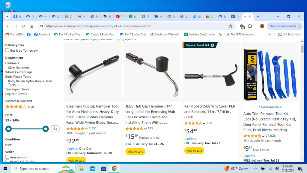

Hate to contribute to Bezos fortune but the guy carries everything.

It's embarrassing for me to have to ask, but what's the best way to get my wheel covers off? Typically wheel covers have a pretty pronounced lip a the edge where it's easy to pry, but my Fury's covers are remarkably flush to the rim face, and there's about half-an-inch of rim past the wheel cover, which I'm not used to seeing. In the manual, it says to pry across from the valve stem, but not how/with what to pry. The lug wrench pry end looks much to fat to get any purchase under the cover edge.
Hate to contribute to Bezos fortune but the guy carries everything. View attachment 673648
Is it just me that finds amusing that all three of us gave links the the same 3 tools?
Yep, I laugh every time that happens. I started at the first post and read through until I thought I could add some information. I hadn't seen your post until I was long past done.
