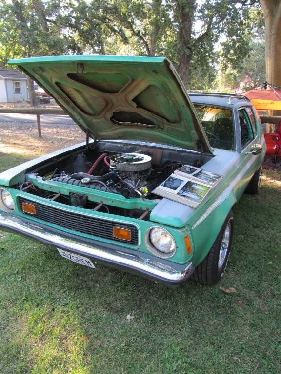

Hey, glad to oblige! No Mopar small block, but a built AMC 401. My Son and I did the work - it's his car. T-10, Mopar 8.75 3.23 sure grip rear.
