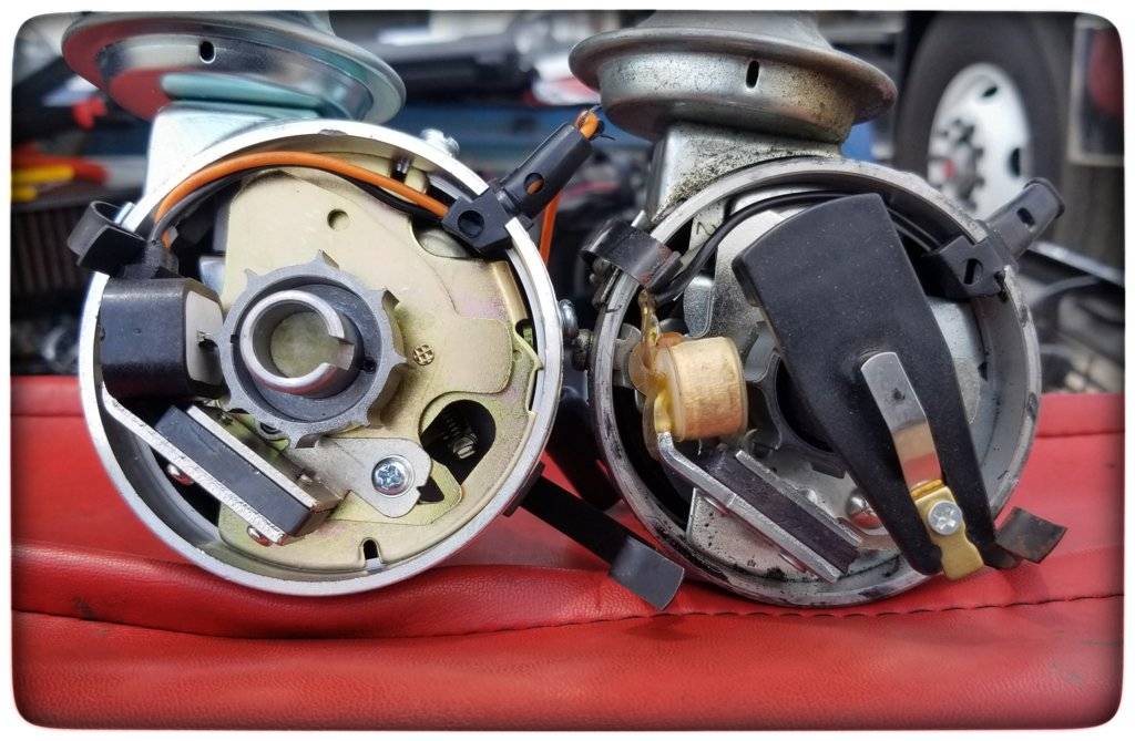

Mechanically the distributor is superior to the MP distributor, although it is bit crappy to take apart if you want to modify advance curve. The main mechanical issue atleast in my MP distributor is the unbelievable braint fart of a design of variable magnetic pickup air gap based on vacuum advance. The sliding plate associated with the vacuum advance is just bad.

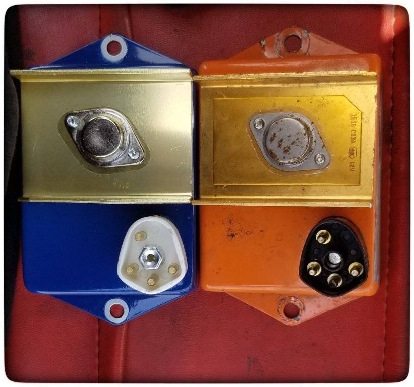

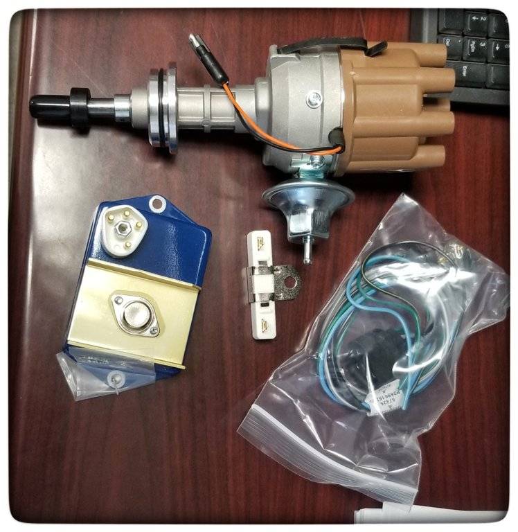

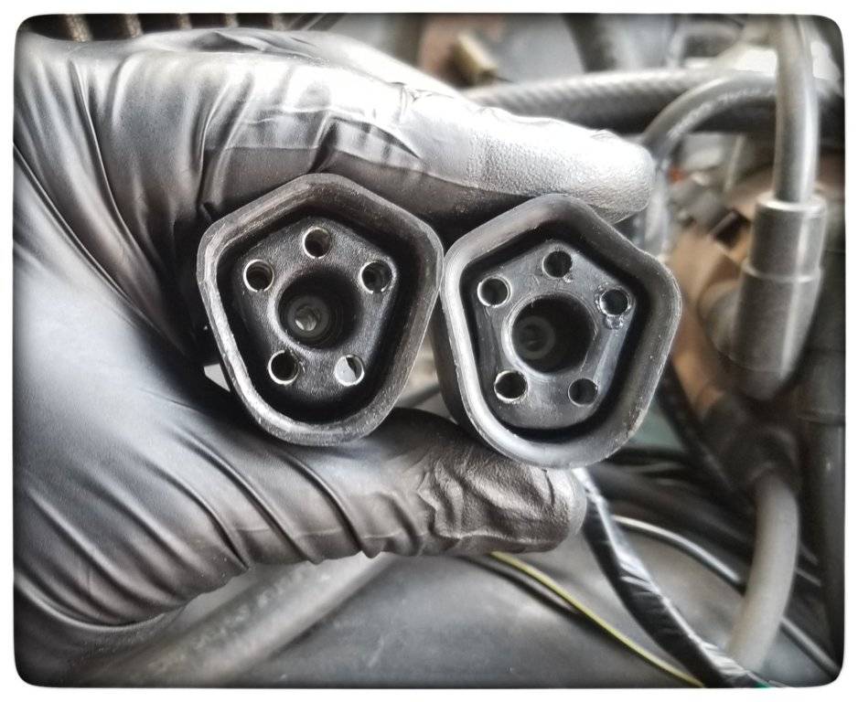

Mopar Ignition ECU info. In the golden days, Mother Mopar made, packaged and sold a quality ECU, not anymore. Plenty of 'off shore' kits have surfaced and I've purchased them. While it DID work for a few years, making if from Portland, Oregon to Charlotte and then to Texas, it started acting up this year. I traced it down to a faulty Orange Box. I got a standard ECU replacement from the parts store, but the Proform wiring would NOT fit the new ECU. After a bit of research, I decided to purchase a HiRev7500 Ignition kit (made in America) distributor/ECU/wiring and ballast resistor. It was CHEAPER than the Proform kit. This pictures show the quality of the HiRev kit. I hope this helps anyone thinking about upgrading their Lean Burn or Points ignition.
The HiRev part looks and feels like the OLD Mopar Performance kit. I can honestly say that the timing light verified how steady the timing was with the new unit. I also changed the coil and the car starts up much easier now as well.
