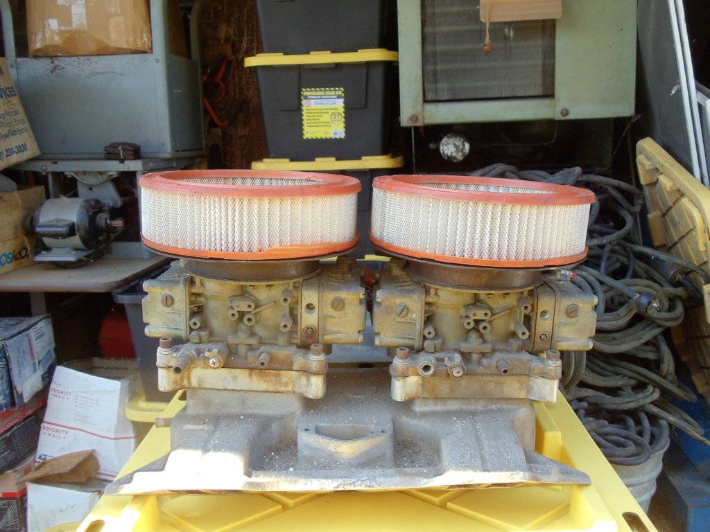

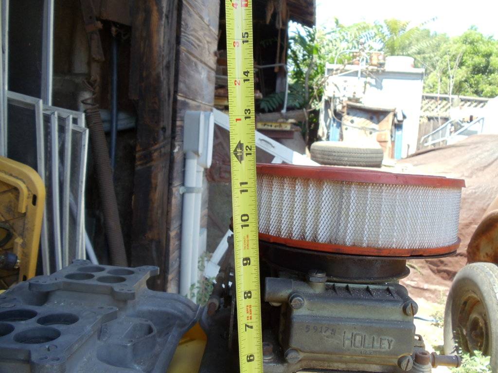

this is my 67 300 440 with a high rise alum eddy and a carter afb , mopar performance aircleaner . and this twin four holleys fit my 383 just under the hood of my 65 880 , would smash the hood padding .

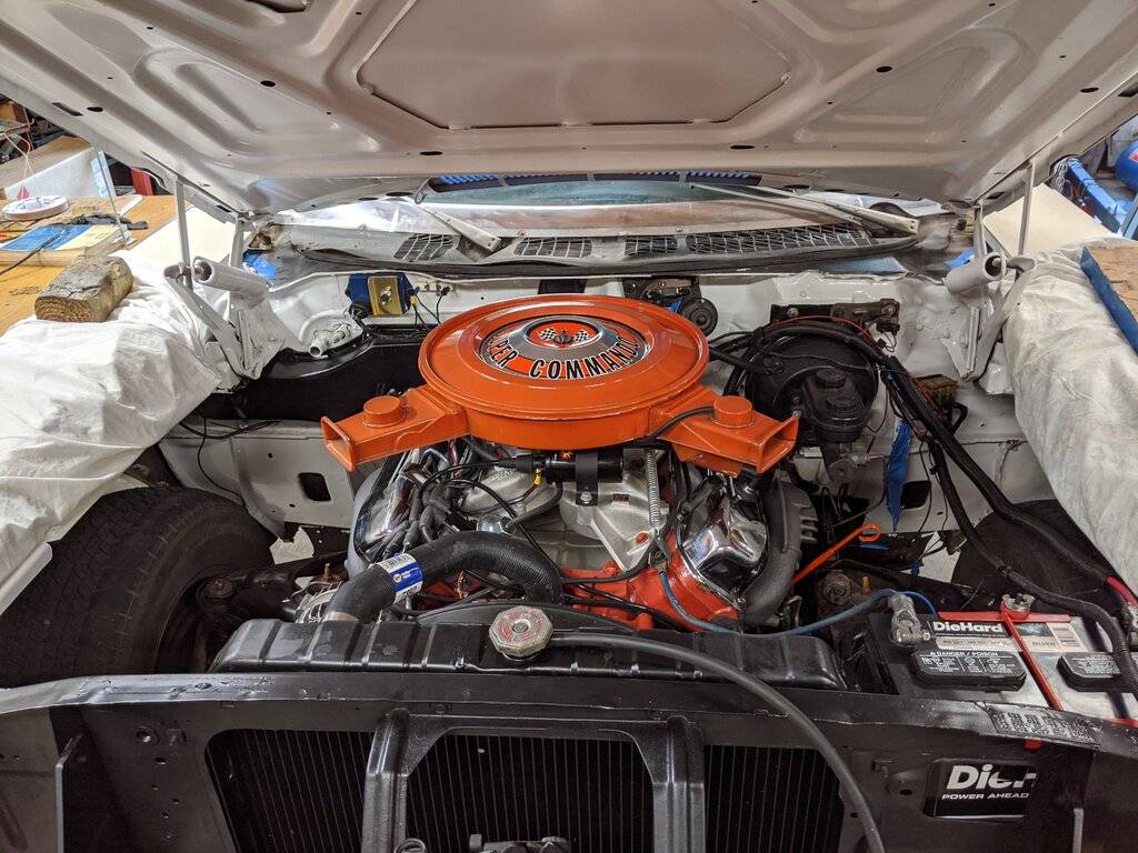

I put the Performer RPM on 440 with AVS@ in 1970 Fury, 1970 dual snorkel, bottom of hood lightly hits to of pie tin. Zero inches clearance. Bad choice on my part. What did you do @Turboomni ?

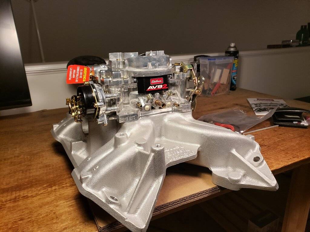

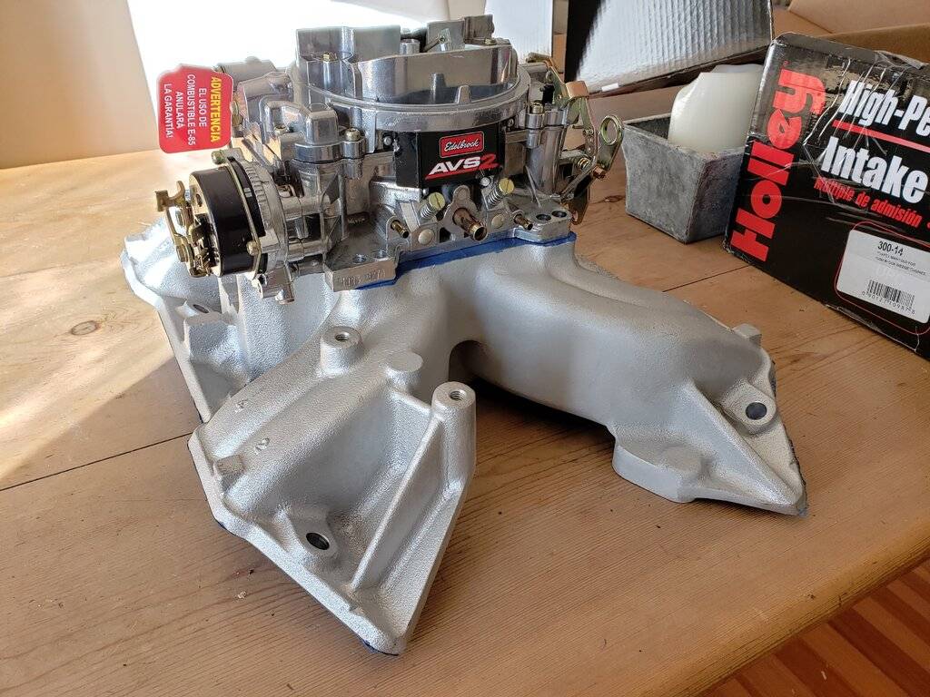

I went with after much deliberation on my engine build which includes being able to use my stock dual snorkel air cleaner ,to a Holley street Dominator single plane intake on my 505 build topped off with a Edelbrock 800 cfm avs2. I had also gone to FBBO as my engine designer frequents there and between all the hoopla we all seemed to agree the Dominator even though a single plane would be best. I will say my engine designer said in a perfect world he would prefer the RPM. But because of my hood limitation he would bless the Dominator. In my situation,tune he said the difference would be minimal. Edelbrock states the RPM dual plane is 1.75 inches higher than stock. Here is a pick of the single plane street Dominator with web removed. I will paint it all turquoise. From what I have read all stock bosses are there like a stock intake.

I went with after much deliberation on my engine build which includes being able to use my stock dual snorkel air cleaner ,to a Holley street Dominator single plane intake on my 505 build topped off with a Edelbrock 800 cfm avs2. I had also gone to FBBO as my engine designer frequents there and between all the hoopla we all seemed to agree the Dominator even though a single plane would be best. I will say my engine designer said in a perfect world he would prefer the RPM. But because of my hood limitation he would bless the Dominator. In my situation,tune he said the difference would be minimal. Edelbrock states the RPM dual plane is 1.75 inches higher than stock. Here is a pick of the single plane street Dominator with web removed. I will paint it all turquoise. From what I have read all stock bosses are there like a stock intake.View attachment 393049
