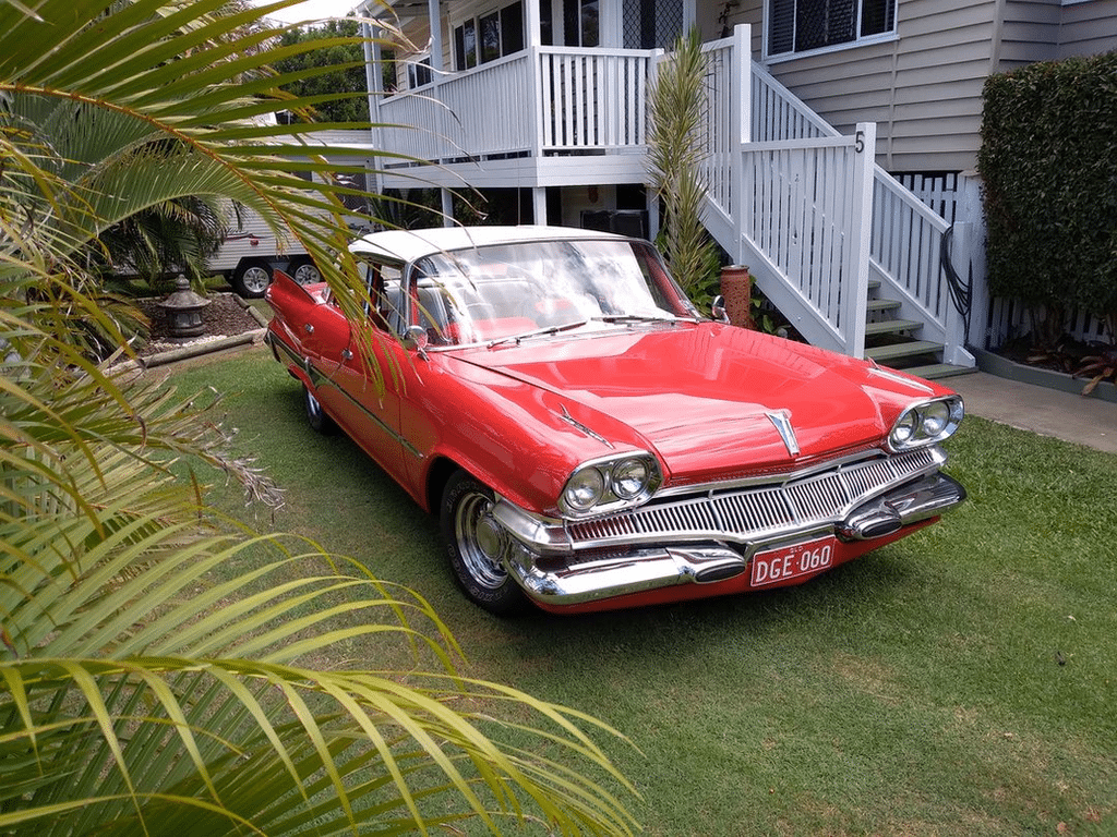

Hello to all. First post here. I will introduce myself soon enough in an introduction thread. As a long time classic Mustang enthusiast and car nut and as a member of a car club here in Hervey Bay, QLD, I want to help a fellow member out.
He's at a loss at to what the issue may be. (Admittedly, he should be asking the right questions to the right people, but alas, I am doing it for him. He's an old fellow with a 1960 Dodge Phoenix, Australian delivery.
I'm posting on this site because upon reading just this thread, I noticed there are knowledgeable people here who would know what the hell is going on with the Aussie delivered US cars here. Picture is of his car attached. His steering has become temperamental in the last few months. Sometimes the wheel is easy to turn other times it's tough. He's just ordered a replacement power steering pump and got that swapped recently. It hasn't fixed the issue. In a way it's made it worse, but he was vague in describing it. As mentioned it was an Aussie delivery/converted. I also know from looking at it that it isn't as simple as a power steering pump connected to the steering box as in my 71 Mach1. His is more complicated. And I am unfamiliar with those setups. Can someone tell me or give me a hint at what the next culprit in the link could be which he needs to look at. (or to the point, get looked at). Cheers Jim.
Thanks to all for reading ... Glad to join, hope to stick around and talk car stuff.
Welcome!
Since the pump did not solve the issue, next step is the pressure valve on top of the steering box where the pressure hose connects to.
Try taking it off the box and clean it.
No improvement replace steering box.

Thanks heaps to all. I'll pass on this information onto him... We met up at our monthly meeting last night... He's a little bit down now with his pride and joy.... His brakes are playing up a little now also... Could this all be related? It doesn't have hydroboost or anything does it? Thanks again to all... Jim
