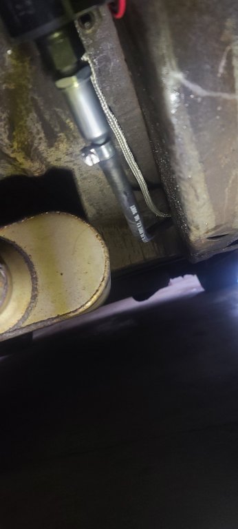

I did mount the new pump lower and at an angle onto the framemrail but realized I only have a few inches between the pump and the muffler. I should probably fabricate a heatshield huh?

Sniper 2 efi needs 60psi ;) i dont run a carb anymore! The 5lbs pump just fills a sump with a float like a carb. So I can and would need a HP pump in the tank for the efi IF i was wanting to get rid of the sump in the engine bay
