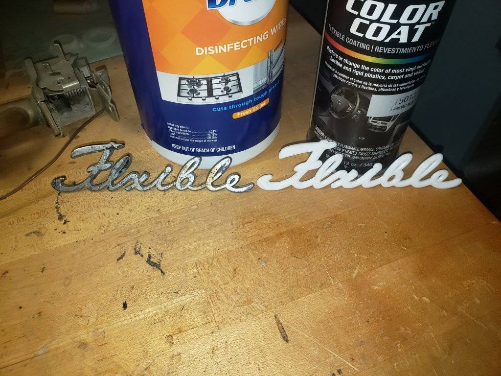

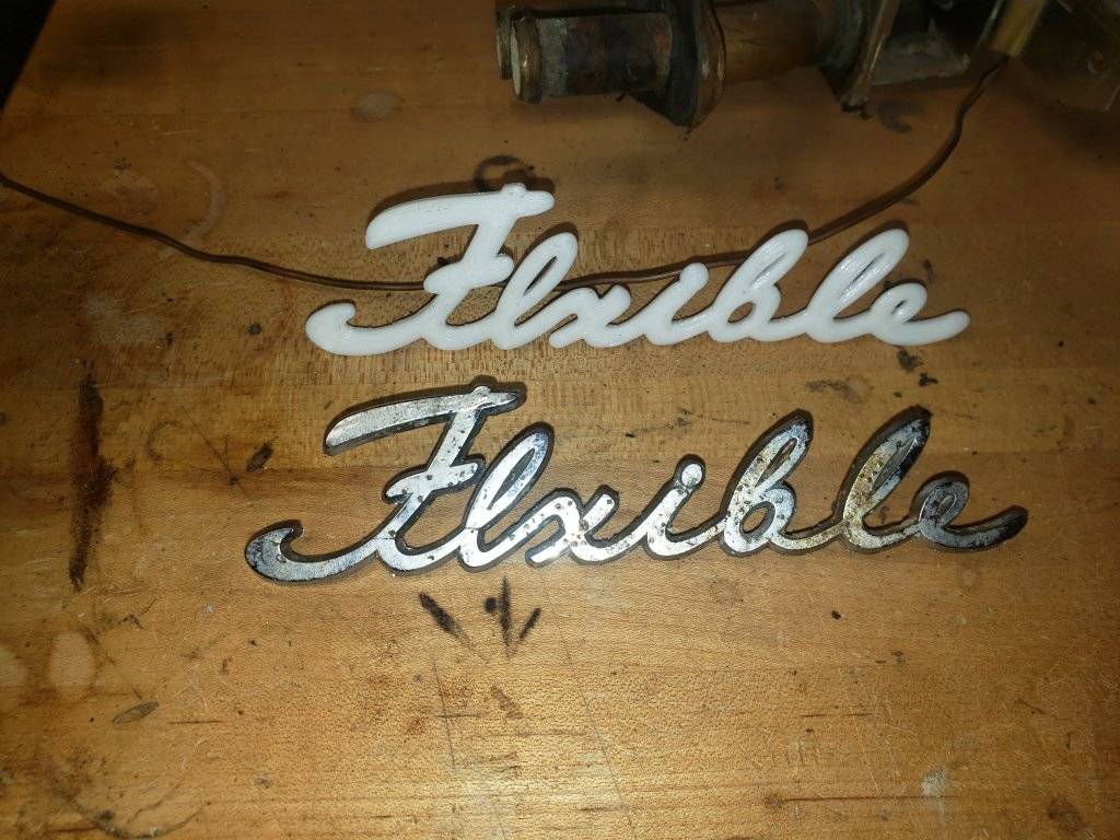

Looking to reproduce these. Local co can do them in bronze, setup /mold is $200 and then $75.00 per emblem made and then would have to be chromed. Local print shop can do them in plastic. $25.00 setup / cad work $5.00 each to print, that would have to be plastic chromed. The printed one is slightly different font, but for 5 bucks hard to beat.

They print shop sent me the cad file for this, they only print plastic. I might try to find a place that can print it in metal.
Just be aware that if they scan the original emblem to print, any defects in the original will need to be cleaned up on the cad file before printing. If the 3 D print is used to make a mold to create a metal replica, be aware that the mold may shrink slightly so the metal copy formed in the mold may be smaller than the original. A buddy reproduces the hood letters for 67 Dodge Coronets, so I've heard about the problems involved. The cost involved is prohibitive, unless you can sell off a large production run of the emblems to break even.
