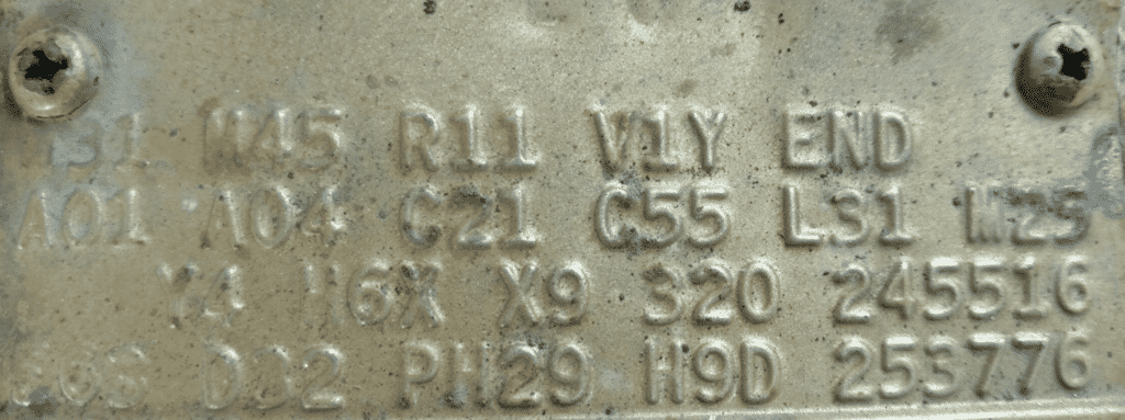

As there is no C body 335 horse assembly, all C body 383s are turquoise regardless of application. This is verified by the engine assembly codes on the broadcast sheet. If you had/saw/knew of an orange 383 in a 69 C body, it will be up to you to prove it with documentation.

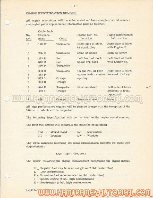

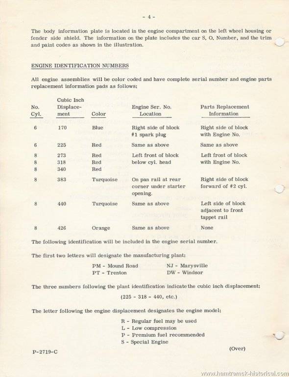

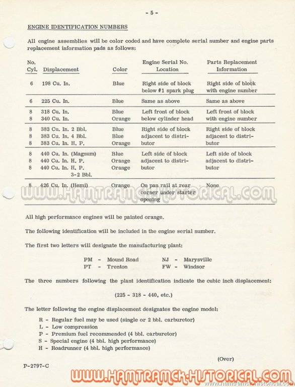

Finding out some of these "changes" is where www.hamtramck-historical.com comes into play, with the letters to dealers which detailed these changes from the earlier published information. Remember the fine print in the sales literature? "Specifications and availability are subject to change, without notice"? (paraphrased)
I found the attached images in www.hamtramck-historical.com, for reference purposes. The first two images are for 1969, the third/last image is for 1970 model year. FWIW.
