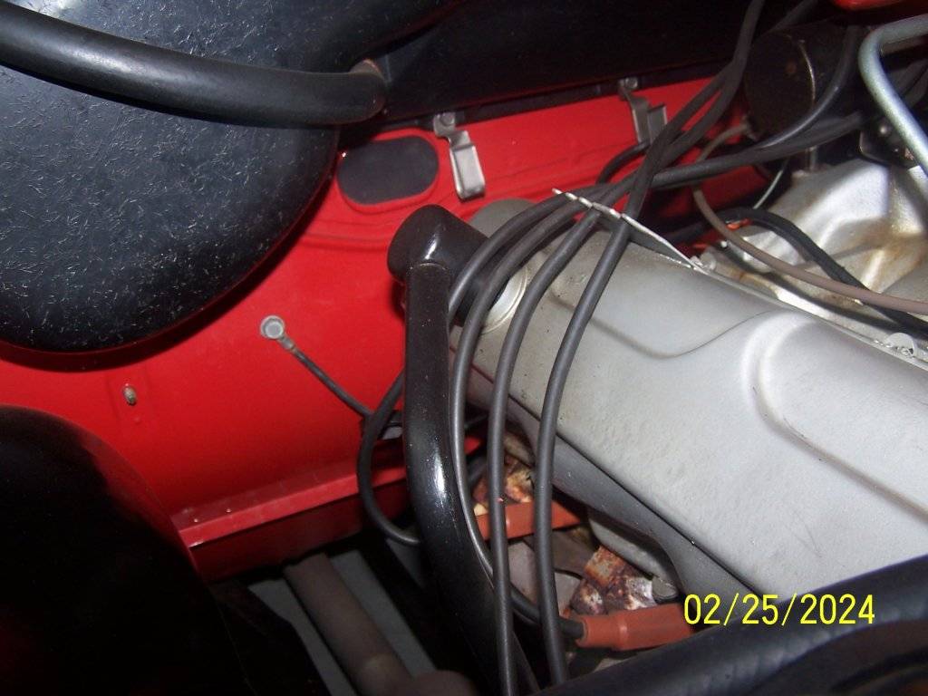

1961 Plymouth. does anyone know what type of ground strap was used between the body and engine?
also, where was it located.
Thanks
Will
I'm beginning to think there was no body/frame ground strap used in 1961. I find no evidence in reference to one in the FSM or parts book.
Pretty sure Mopar grounded them all pretty much the same from the 50's and up. (Between the firewall and right rear of the head)
I just checked my 60 Dart. Not sure if this wire is original. Since I restored my car back in the 80's I don't recall if I replaced it or not but that is where it is. I didn't check the FSM to see if it is shown or not but if your car doesn't have one in that area, I would certainly install one.
