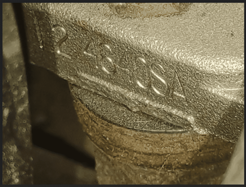

Stock Carter. Part number below:

Yeah... I was told that. Apparently, the original Holley carb was replaced at the dealer in '69. Any idea what the cfm is for this Carter?
750 CFM.
From the intrawebs, taken from Dave Emanuel Carter book.
