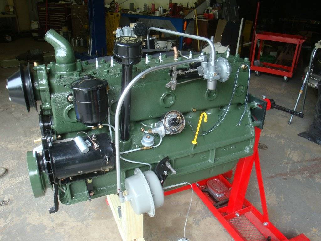

I had to do that on a 1948 Packard that I did some restoration work on some years ago. New pumps were not available for that particular engine and the internals of the pump were in good shape. The spring had just lost some of it's tension over many decades.
