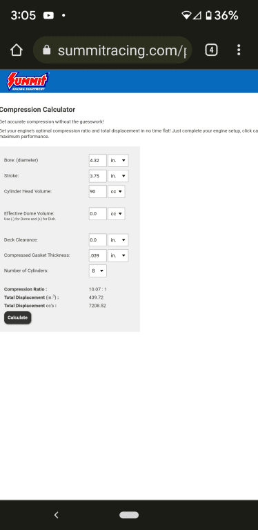

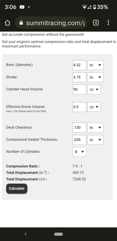

Milling the heads is useless without milling the deck and a piston change. Now you are into a complete build. Any pistons you are getting off the shelf that don't cost $800-$1000 a set are going to put you right back in crap compression ratio. Someone mentioned milling the heads to 90cc hear is what that gets you if you also deck the block to 0.0 and use stock cast type pistons.
Here is what you really get from the average mid70s 440 or 400View attachment 558806
Now you could mill the heads and replace the pistons with some KB step head pistons and you might get to 9+:1 compression, but that's a good chunk of change, a lot of work and probably net you 25-30 horsepower and a mile or maybe 2 pet gallon fuel mileage.

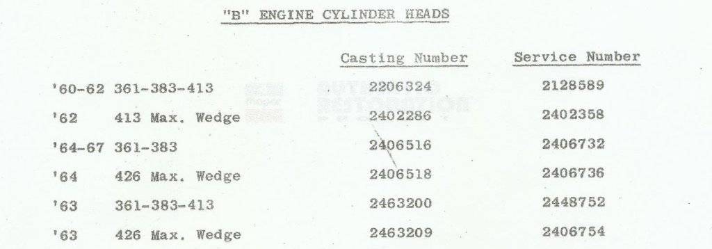

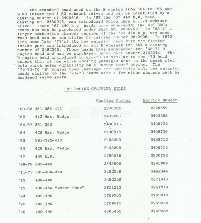

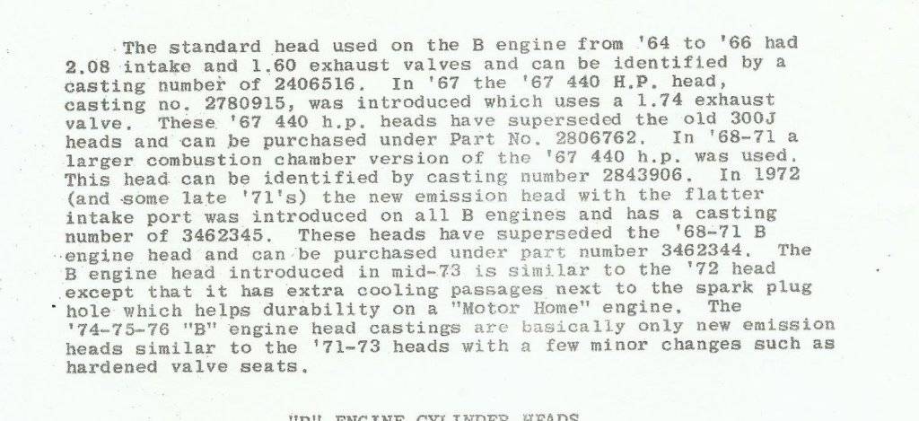

well it will help verses the 8-1 pistons & heads combo or u can go out & do s full rebuild &high lift cam . now a low compression motor is perfect for a turbo/supper charger too but u r talking lots more $$$$$$$$$ too these came from the old direction racing book (it was written by the same folks that brought u the Ramchargers cars from the 1960's( its what the the super stock racing series guys still use today
