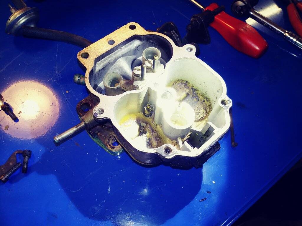

This is my carb after I dropped the tank and had it professionally cleaned and new fuel filter installed after blowing out the lines.
Still collected garbage from the fuel system.
Car sat for 6 years.
