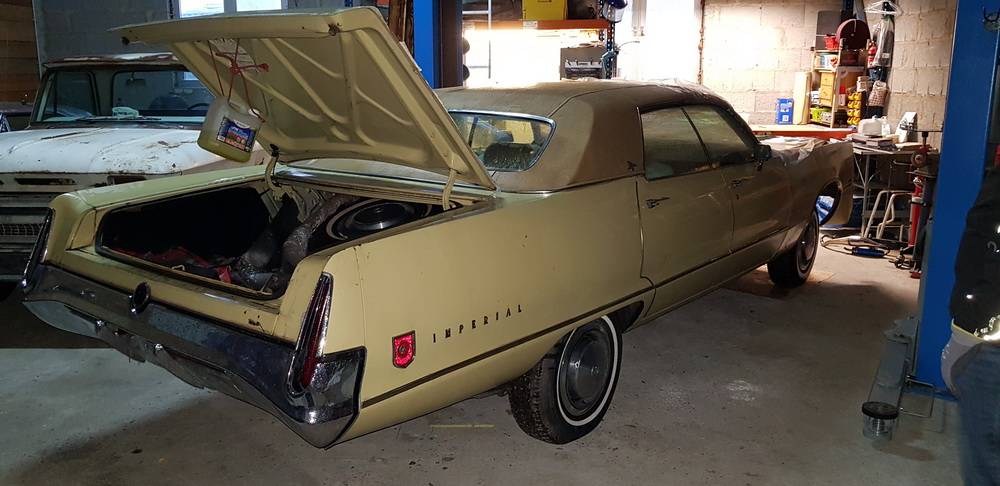

found a similar color but can't tell if the color is Y3 or Y4 or?

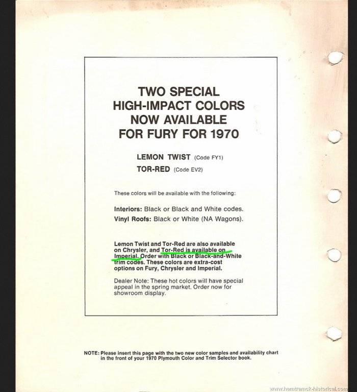

Hey Doc, While we're talking colors, I may have found the magic unicorn to keep an eye out for. I know it's not your favorite year, but how about a Hemi Orange '70 Imperial coupe, with white top and interior? I've never seen one, but it looks like it was available. I just came across this the other day on the Hamtramck Registry.
I think, looking at the chart on the online imperial club in 1970, Tor Red isn't listed, looking at 1971 colors you'll notice a D and P alongside it meaning a color for Dodge and Plymouth only. Looking at Spinnaker White there's the full range, C, D, I,P Aka Chrysler, Dodge, Imperial, and Plymouth.
Such a car "could possibly" have been specially ordered, though whether any actually were is open to conjecture as I don't believe such production records exist. I guess if you had the cash, and Chrysler were willing then anything's possible.

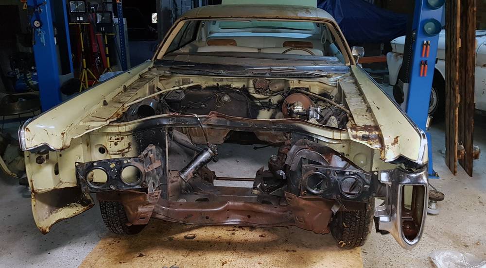

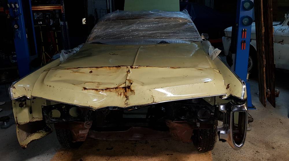

I bought it for parts. Sheet metal wise, I need the entire floorpan, the trunkpan and the lower quarters, the cowl and parts of the front window frame.
Further, I will use the floating caliper front disc brakes instead of my Bud Brakes. I hope they will swap over easily.
And a lot of small parts and pieces will find their way onto my car as well!
I suppose there could be some super heavy duty, high dollar, made in the USA, come-along that might be able to do it, but who's going to have one of those?

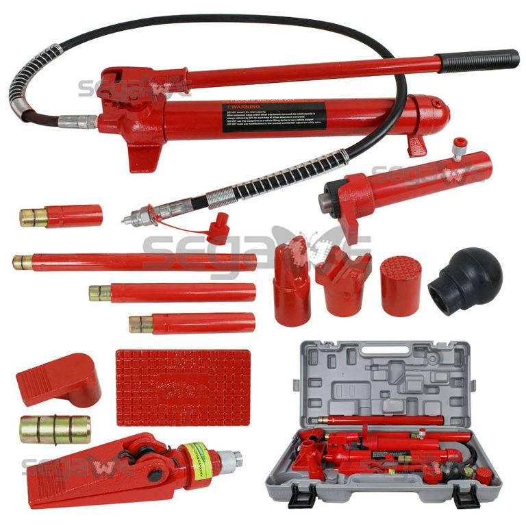

10 TON PORTA POWER HYDRAULIC JACK BODY FRAME REPAIR KIT
Most RentaCenters have them for rent, heh I've used this many times.
If you use to straighten a stub frame horn, make sure you have Oxy/Ace big *** heat tip to heat a large area of the frame 'Cherry Red'.
If you don't and do a cold push or pull it will crack. :eek:
