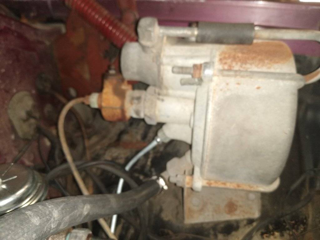

Ever see brake booster like this?
Rusty Muffler
Feb 11, 2011
410
123
Petaluma, Ca.

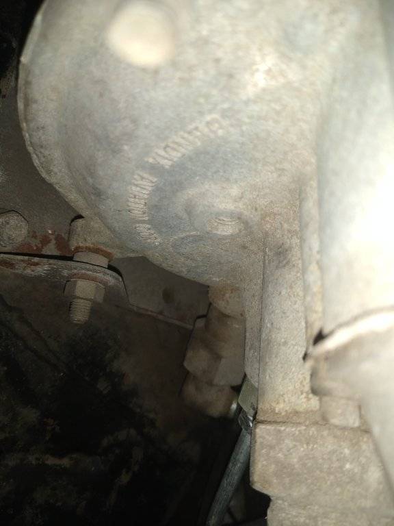

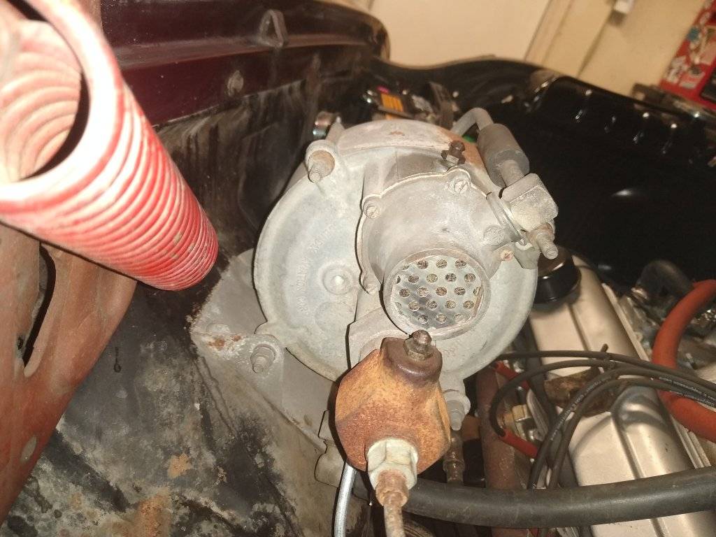

The odd brake noise was actually coming from an air inlet on this booster. Says Bendix Aircraft Corp on it. The inlet has a sort of coarse brill fabric under a screen with a snap ring. The sound would come from it intermittently when at a complete stop. It sounded like metal to metal but couldn't be. I haven't found any info on this and there's nothing in the FSM. They list a Bendix rebuild kit on Ebay but doesn'
t look right and is $275. for about 4 gaskets.

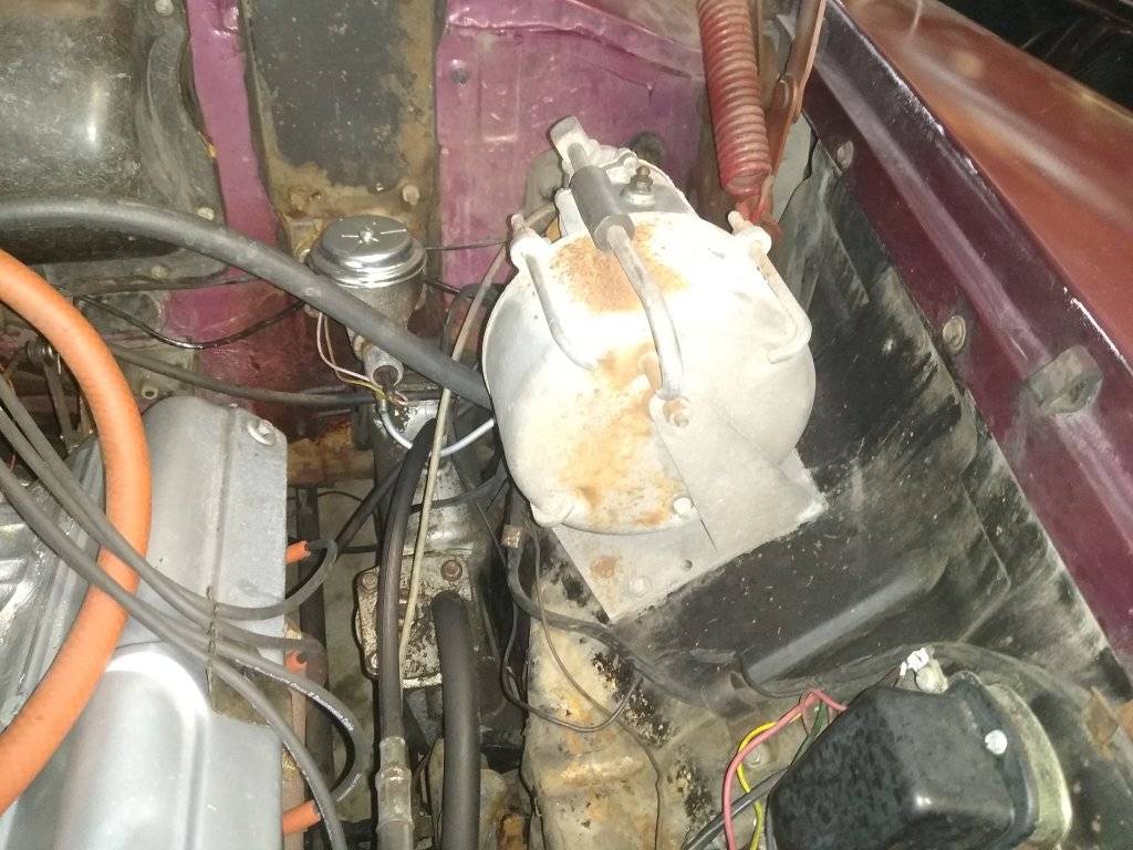

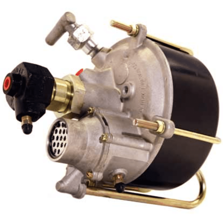

Interesting, I've never seen one like that. Definitely not stock. Looks like an aftermarket "after master cylinder booster". Probably an easier option back then compared to installing a traditional stock type booster. I doubt parts are available. Probably best to ditch it and go back to manual, or go the stock route. Now would be a good time to install a dual pot master cylinder.

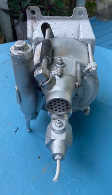

That looks like a HydraVac type unit from something European. They didn't call it Power Brakes over there, it was Servo Assist or something.
What is it on?

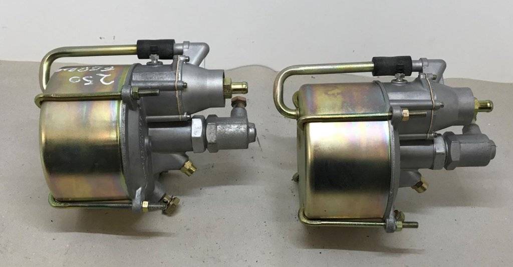

Your right, just found one from a cadillac that is a close match. Don't think it's european though

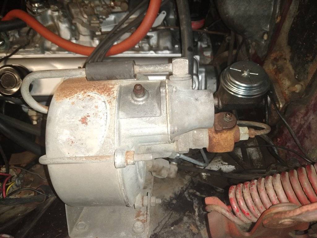

Is it operating well but you have noticed the sound? I would pull that spring clip and clean out that screen, won't hurt and could probably use it after all these years.
Looks like there's a grease port on the unit itself and the fitting leading to it. That fitting is likely a backflow valve which may make a metallic sound. Try greasing it (if you haven't) and see if it persists. Could be just that valve that needs replacement.

Mmm, I'll look again but I thought that was a bleeder?
