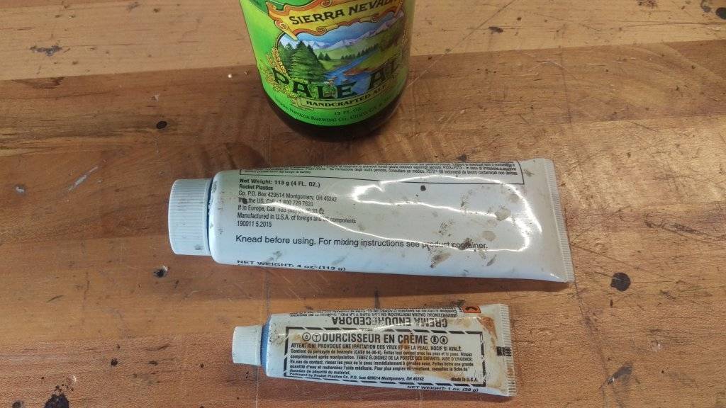

359 4oz blue "keg" vs 360 1oz tube. Bottle for reference.
p.s., the 359, 4oz normally comes with a gallon of their product. The 1oz comes with quarts.
Oh, everyone's hung up on the word Keg. Marketing. No difference between Blue and Keg blue. You can buy 4oz blue, or a 4oz "Keg" of blue. 'muricans like Kegs.
