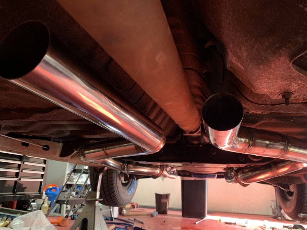

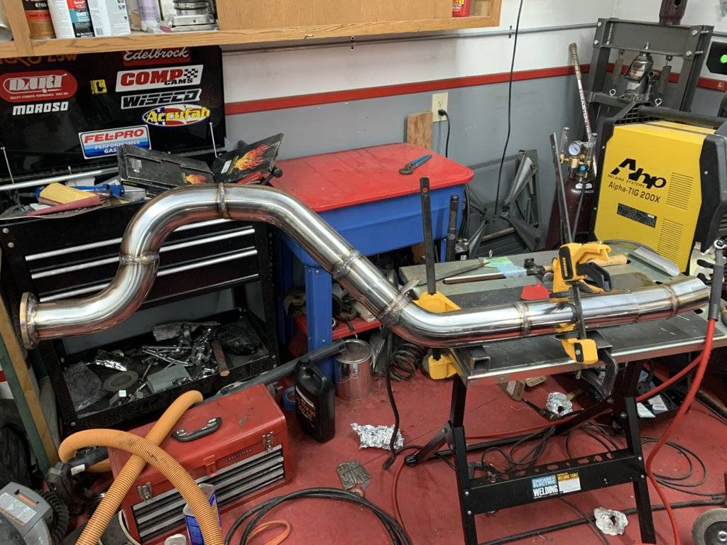

So I’ve been building up a 75 royal Monaco coupe. 400 now a 512. I went with the hooker headers for it and made my own 3” exhaust out of 2 stainless exhaust kits off eBay. Lots of work but doable on our boats. I can get some full photos later if you’d like to see as far as clearance and routing.
Apologies if I mislead you sir, my exhaust is NOT stainless.. it’s galvanized 2 1/4 pipe which common use for replacement exhaust.. if you don’t have access there where you are, maybe you can order couple sticks of pipe and have it shipped. Just a thought.Looks very good @75LandYacht , tips about offset are very interesting too, and helpfull. That's probably how I'll do. But here in France, working on american cars are not so common than in the US, and for a stainless dual exhaust line, that'll cost me way more than $450...
