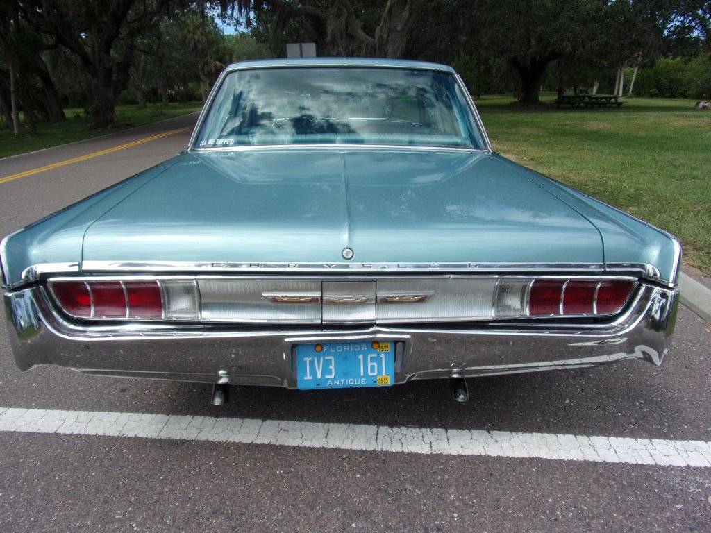

Hello all,
I am still trying to solve the issue of exhaust fumes in my '65 Town Sedan. The trunk floor is completely solid; all body plugs in the rear valence are in place; deck lid weatherstripping is new, and expertly installed by yours truly.
I have chrome exhaust tips just past the rear bumper. I've had the car up on my lift, and I can see no obvious exhaust leaks in the system. Any ideas? Thanks.
Might wanna straighten that bumper out. LOL!
The tips appear to be facing downard.
Try a 45 degree angle?? Pull the tips out 2 inches?
Thanks 'Burn. My next shot was to take the tips off completely, which makes no sense, but I see modern cars and can't see the pipes coming out the back at all. My Riviera does not have this problem.
How's the new Monaco?
Sleeping waiting for spring.
But yes it has the factory tailpipes with the tips BEHIND the rear bumper..no fumes.
When you get around to it, the steel brake lines on the rear axle housing are improperly located. They should never be below the axle as they could get hit by road debris and get punctured or torn off.

Hello all,

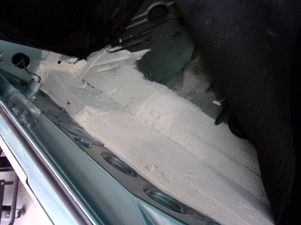

Thanks gents for all the input. I think I solved the problem. Under the trunk carpet, the trunk pan had been repaired, obviously due to an accident. The welding job was pretty good, but, there were a number of small holes that were missed.
I applied several buildup coats of Lanco roof coating (a latex-based material, it rolls or brushes on, and is extremely versatile), and voila! problem solved. I suppose some dynamat would have worked well too.
