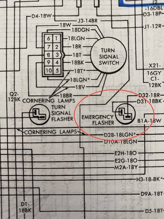

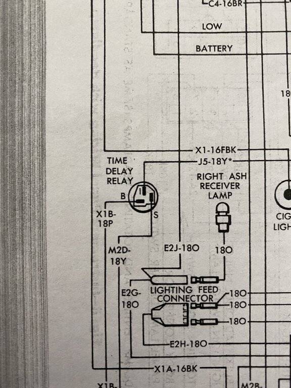

A couple of questions regarding the emergency flashers: I installed the grounded turn signal relay and reversed the polarity of the socket and it works great. I have never had working emergency flasher in the ride and noticed an empty socket next to the turn signal relay, but it is a three wire socket. Is this for the emergency flasher relay? Is there a different one out there with three blades?? And if so, I assume it too would need to be a grounded variety like the turn signal relay??
Disregard. After consulting the FSM wire diagram, I think that empty 3 wire socket is the “Time Delay Relay”.
It looks like I need to find this relay/socket:
Anyone know where this is hiding under the dash of a ‘68 300?

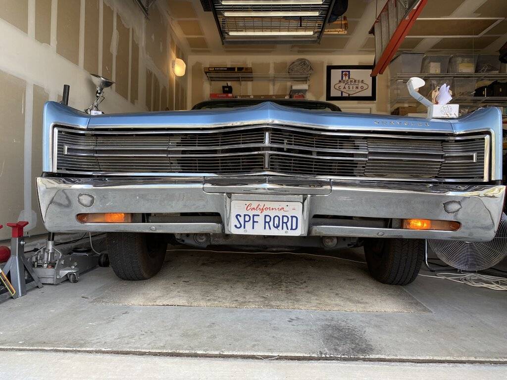

in the meantime, I did the parking lights in the front bumper too. You can see the difference in this pic (driver side is the LED).

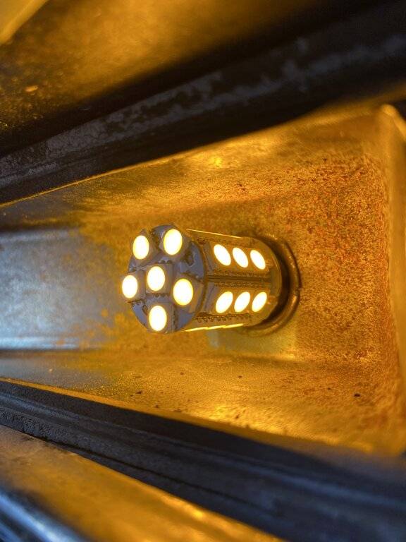

And here’s a close up of the bulb itself:

If those are the type of LED bulbs that are amber running lights and also flash amber when the signals are on using the same LED elements, you may not be able to use them. I was not able to on my 66. Long story short is: What was originally 2 separate circuits with the original 2-filament incandescent bulb is now tied together using this bulb, which causes some interesting power backfeed in the system.
If so, you need "switchback" bulbs with 1157 base. I used the following. They are white as running lights and amber as turn signals.
https://www.amazon.ca/gp/product/B075R4V43V/ref=ppx_yo_dt_b_asin_title_o08_s00?ie=UTF8&psc=1

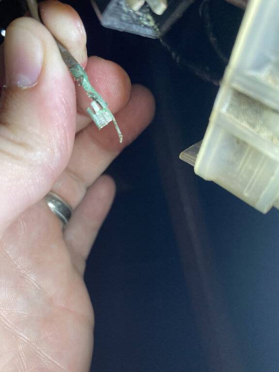

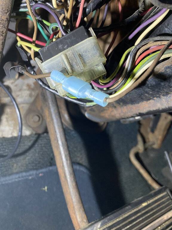

I am starting to dig into my issues and decided to start with the connector at the base of the column. My intent was to clean the pins with deoxit and reassemble. But upon opening the connector, I noticed one of the wire connectors was broken.
hard to see it in the photo below, but it is the sexond from the right in the top row. If I trace this wire correctly in the FSM wiring diagram, I think this leads to the tail/stop lights in the back.
I pulled that wire from the connector (second photo below), but can’t figure out where to get this type of terminal for the wire. Hoping I can find it locally so I can get her back on the road.
Can someone tell me what type of terminal this is?
I see green death.
For now if connector is not available make a jumper wire to see it it is the problem.
If still no power going to brake lights then TS switch may be bad.

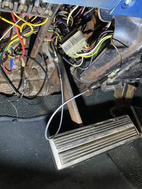

that connector/wire appears to be the culprit.
tested it with a jumper:
And gave it a temp fix bypassing the connector and installing an insulated spade connector:
I live to fight another day!

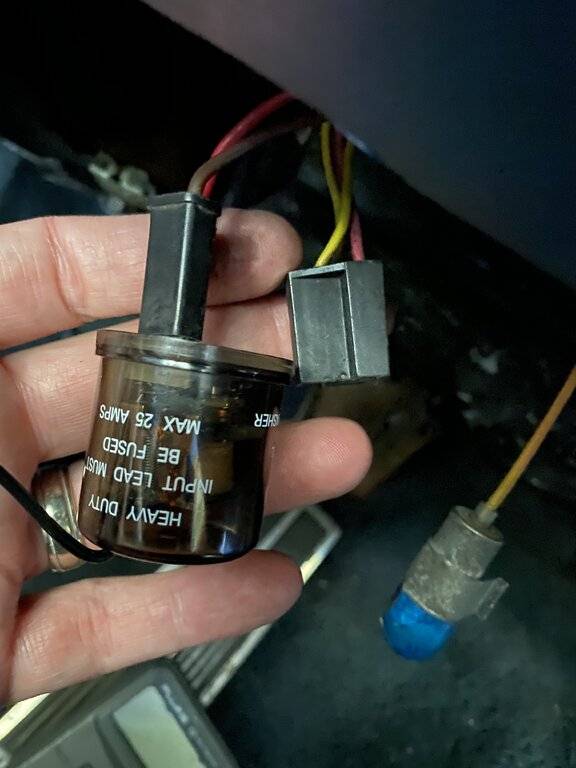

This may change once you go all LED. The remaining filament bulbs you have on the circuit might be drawing enough to allow the flasher to work properly. My understanding is with the low draw of leds, the ‘analog flasher’ will make then hyper flash.

Just get an electronic-mechanical flasher, and you can go ALL LED, sans resistive loads or misbehaving circuit branches. $8-20, depending on what brand and vendors you trust.
