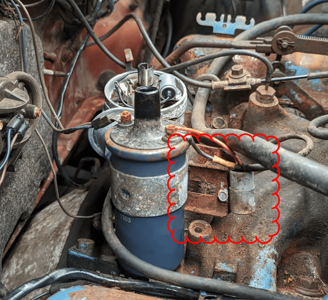

Ok, folks, I have a question.
Last week my Fury just died at an intersection. no spark.
It had been getting harder and harder to start over the previous few weeks, would have to crank for 10 seconds or more and when it did start I had to hold the throttle and keep the idle up for a minute or so before it would stay running. once it was running it seemed to be fine.
Fuel is good, and will turn over strong. tried starter fluid and got absolutely nothing.
Pulled the coil wire, set it against the block, and cranked it. no spark.
I go to pull the coil off to test it and there is this extra condenser beside the coil that I don't find in any diagram, and mine is attached to what is clearly a poorly sawed-off part of some other bracket and held on by a tech screw. definitely not factory.
So, what is this extra condenser?
If I am not mistaken (and I just might be! LOL) I believe it is used for radio ignition noise suppression, I don't think it has any other purpose to the ignition system.
As mentioned, it's for the radio. It serves no other purpose. Looks like there's some corrosion on those nuts, I'd clean them up and check other connections and battery terminals, bulkhead connector...
that radio suppressor condenser goes to the positive side of the coil

Looking at the photo in the first post, it looks like a small block. When did they start mounting the coil vertical instead of horizontal? And the vacuum line coming off the manifold using a reducer fitting, isin't that supposed to go to the brake booster? Where's it going on that car?
the coil isn't attached, i took the clamp off and stood it up so I could see it better
