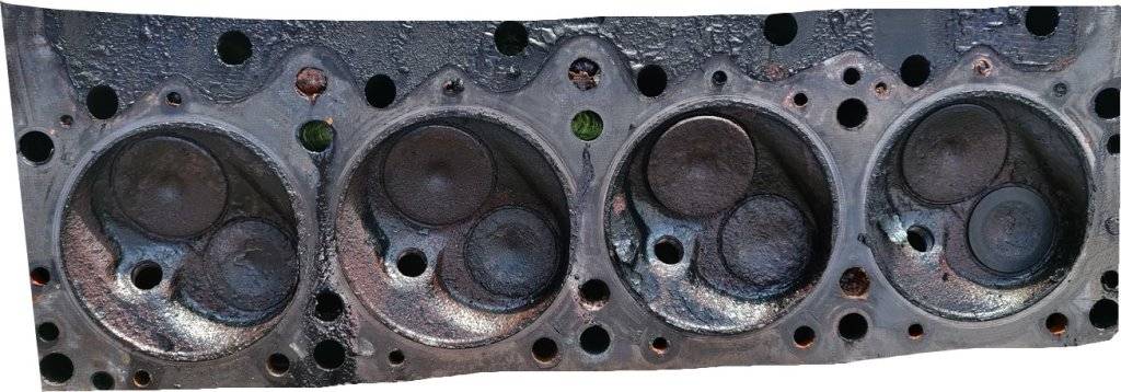

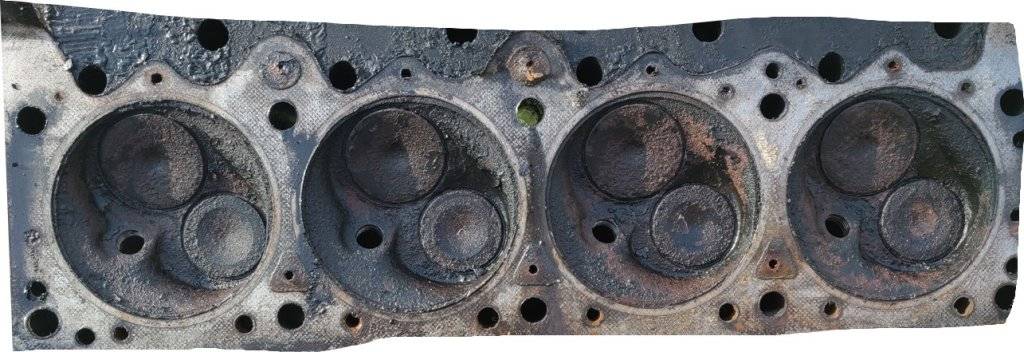

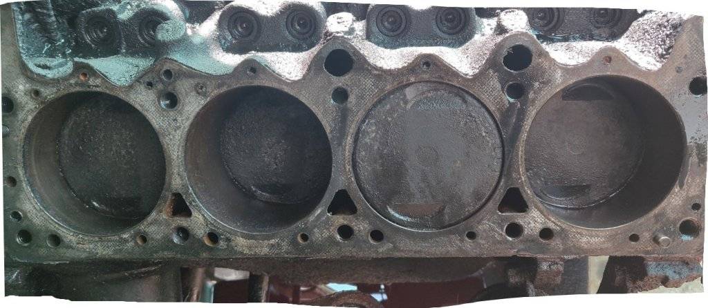

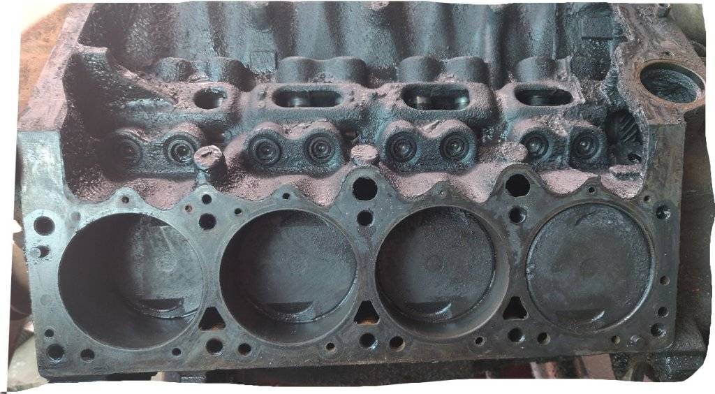

Got the heads pulled today. Cylinders look better than expected. Don't see any major scoring, rust or ring ridge. Still could not get the engine to turn over. Valves look a little rusty.
Those 2 exhaust valves in the middle, top of picture, are exaclty the condition I was thinking of when I mentioned pressurizing the cylinder and popping the valve stem with a deadblow hammer. Lots of crust would be coming out of those 2.
What would remain of those seats would probably be enough for it to run poorly, and likely burn the valves, but as longs as you got all the crud out, it wouldn't harm anything. But it didn't unseize, so it's a moot point.
If that engine doesn't have a spun bearing preventing it from turning, I'd remove whatever gunk I could scrape up, scrape and power wash inside the coolant passages, clean those heads up and lap in the valves and probably clean the lifters, put it back together and run it.
It would be mostly labor and not much in parts and you might get lucky in having a decent running engine.
I say that only to me pulling an engine in and out of these car is pretty simple and to me worth the risk of having to remove the engine again for a rebuild.
If the pistons can be worried out of the block, and the cylinder and piston pitting is minor, and it doesn't take "any or much" material removal from the cylinders to clean them up with a hone: I would hone, re-ring, and run.
Hopefully the cam and lifters clean up good with whatever the appropriate cloth is. I would be surprised if the crank and bearings aren't clean.
The heads? Well, that remains to be seen. 50/50 on that. I expect some iffy valves, seats and guides.

I say this knowing very well the cost of overbore and pistons. I would rather run a properly machined factory original motor that has been cleaned up than a rebuild job.
