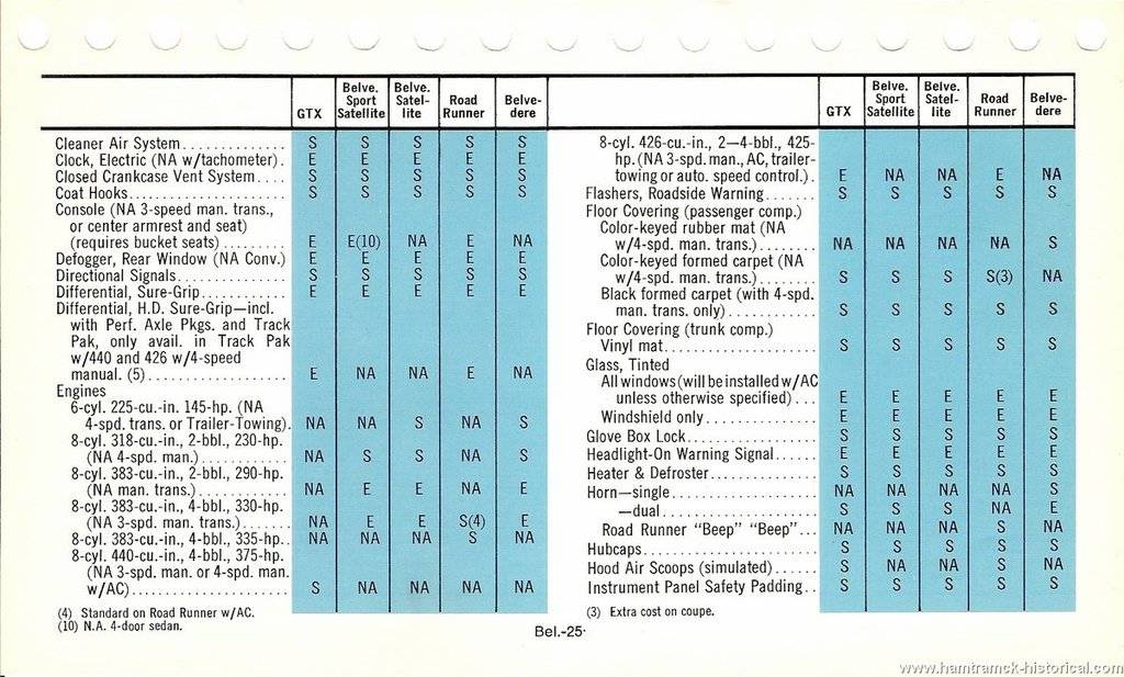

If you mean '70 Roadrunner, then no. This is for 1970. Again, this is the regular Roadrunner and not a Superbird.

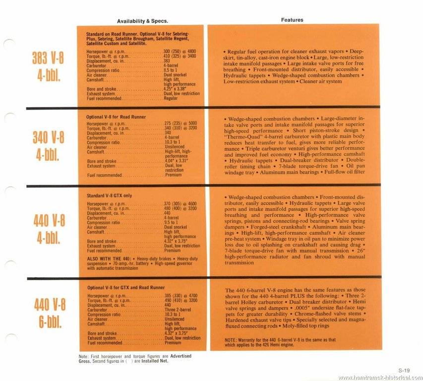

1971

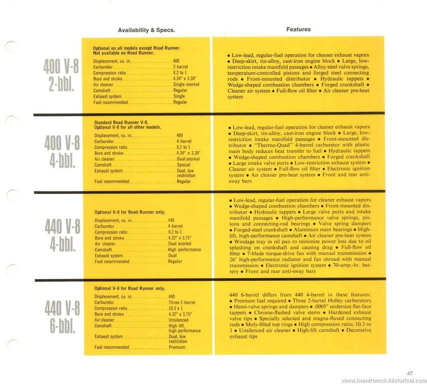

1972 This is where the 440 4bbl starts.

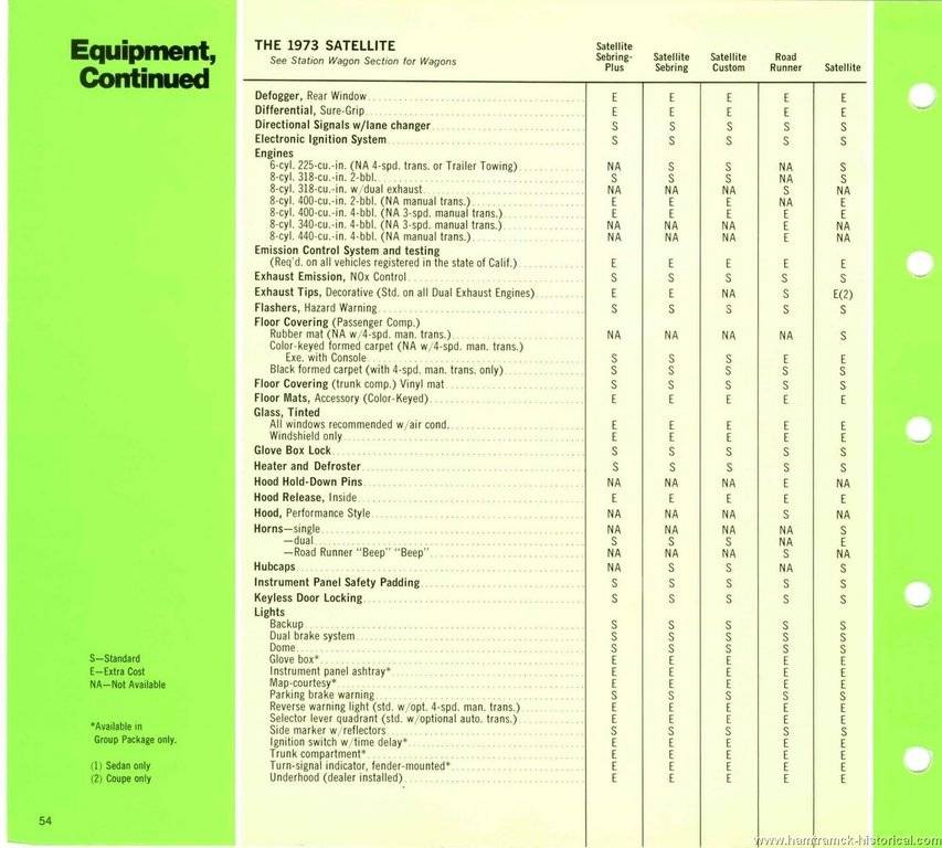

1973. Note NA with manual trans notation

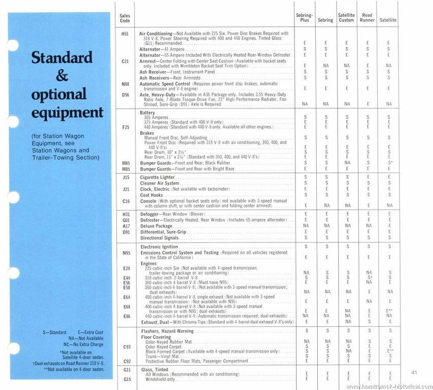

1974

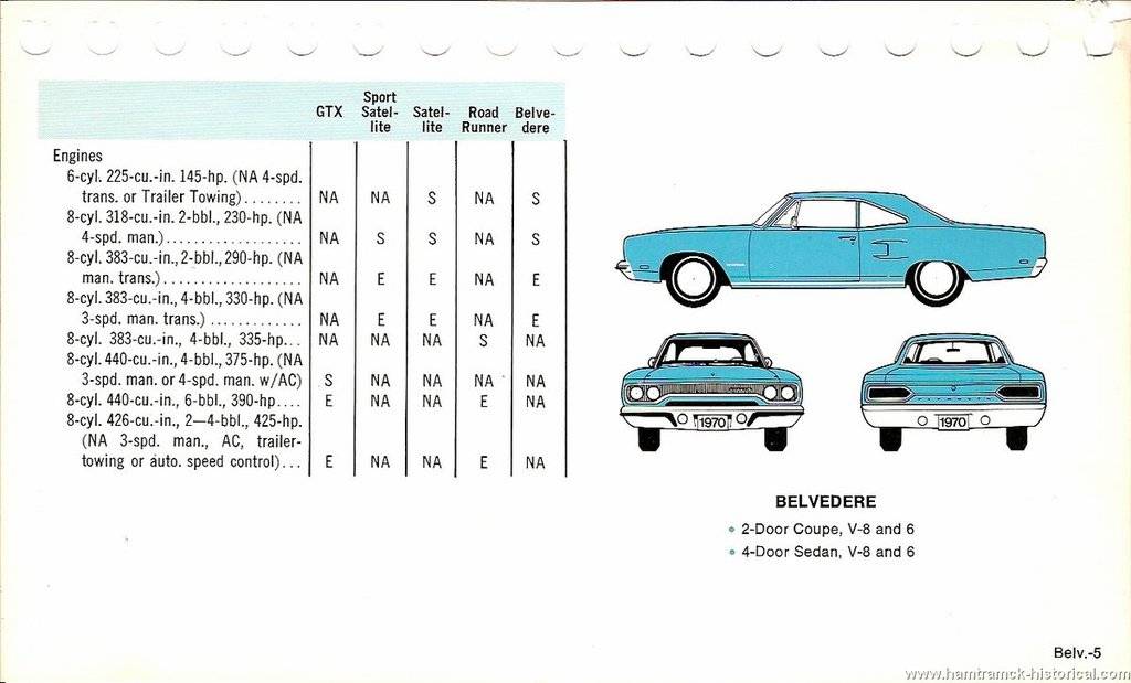

And just for good measure, 1968
and 1969. It doesn't list the A12 440 6bbl option as that was a mid year option.

Is that none period?
Or is that saying not available with 440 4 speed with a/c? These factory literature things were always vague to me.
No 440 4bbl in a Roadrunner, except the Superbird, period, until 1972.
