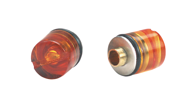

I have a pair of NOS fender mounts and it appears as though the lens does unscrew. The Year One replacements seem to verify that. Holding the new ones in my hand I see no way of getting to the bulb from the bottom. I'd be really careful disassembling them and it may require some penetrant.
1966-74 A B E-Body Fender Mounted Turn Signal Lenses

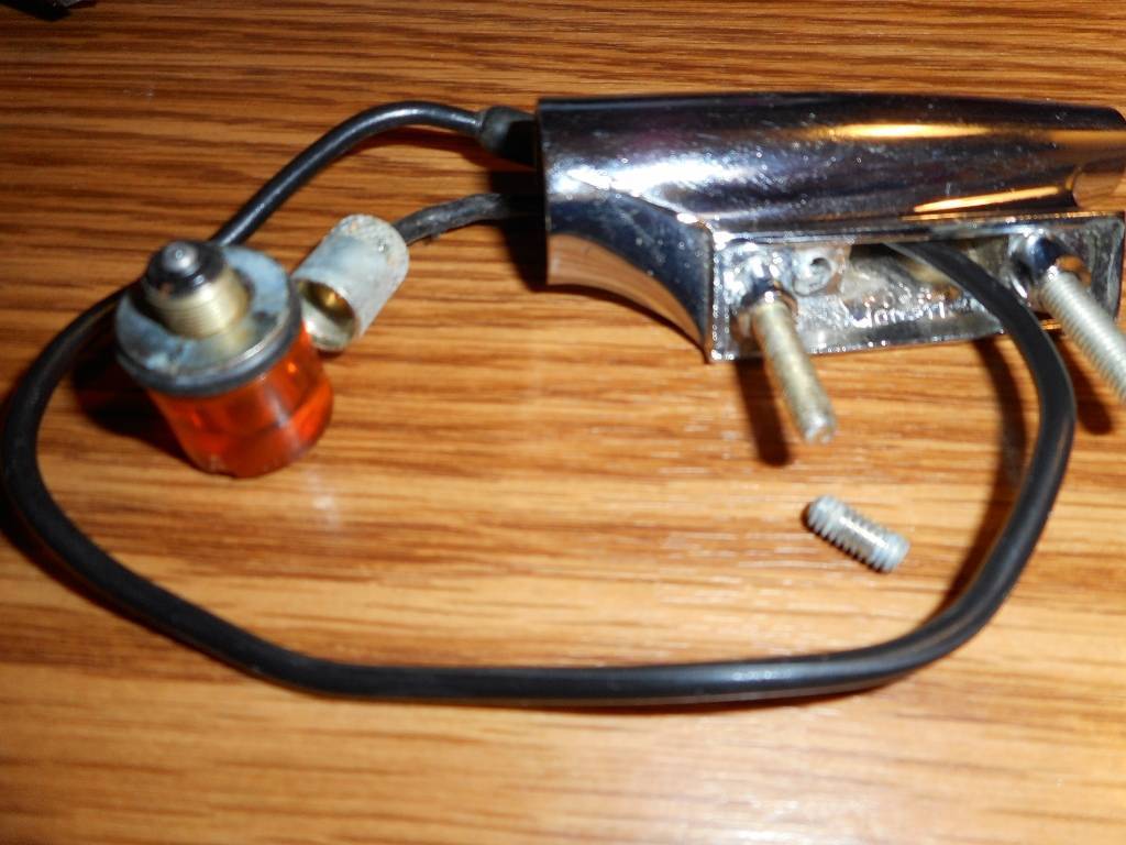

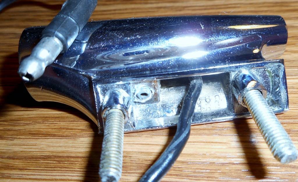

Early models had no slots for removing the lens. It was changed later. So the only way to remove was to loosen the set screw from the bottom that actually holds the socket. Because of the dissimilar metals they often corrode and shatter when removing.

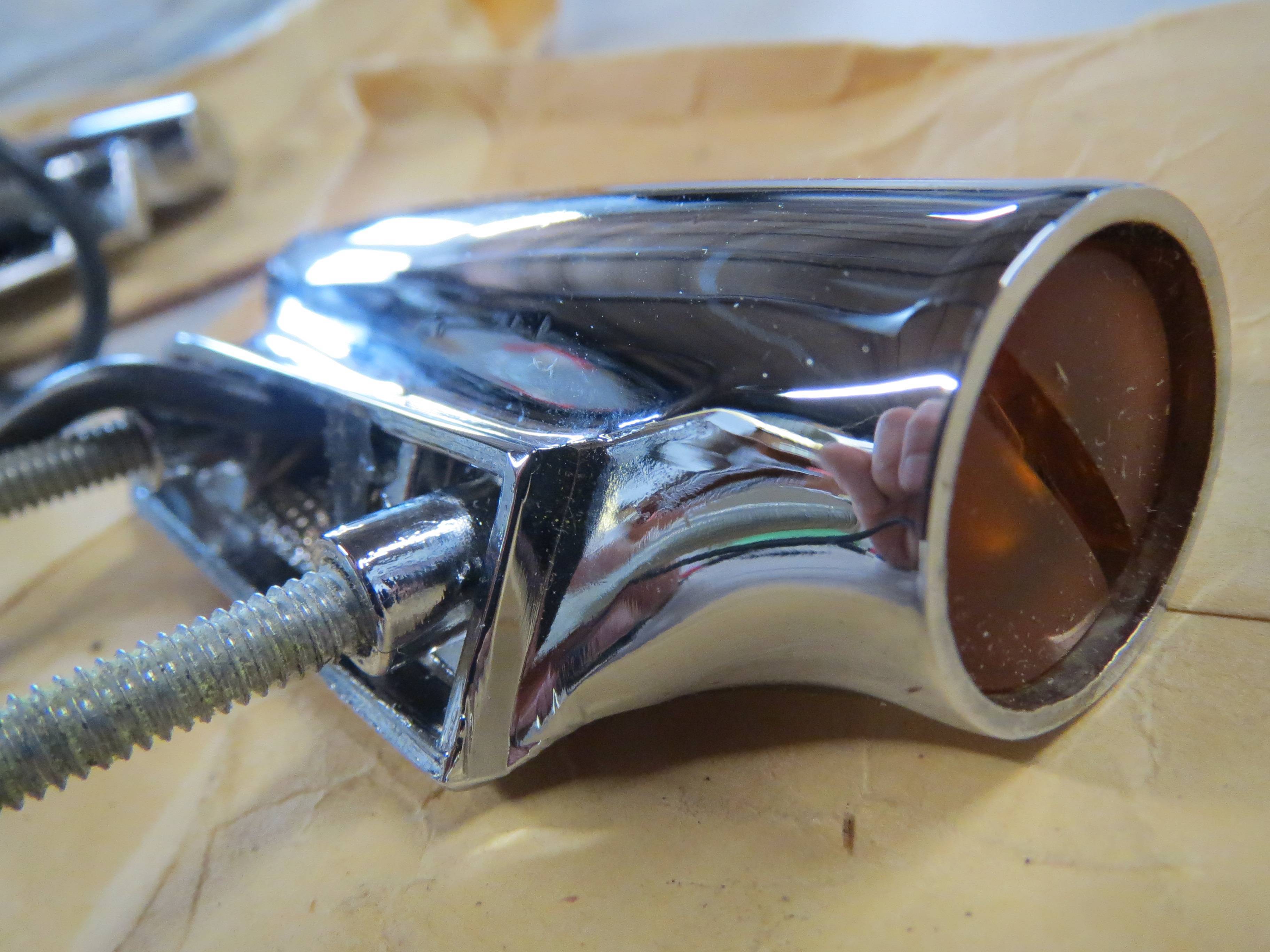

this piece is a NOS piece.
Ah ha, I see it now. The set screw tightens against the socket on the end of the wire. I haven't seen that on mine because they must have put a small dab of adhesive on it to keep the gasket with the part. My set screws are covered by a small piece of the gasket that stuck to it. I'll have a closer look when I get to the shop.
