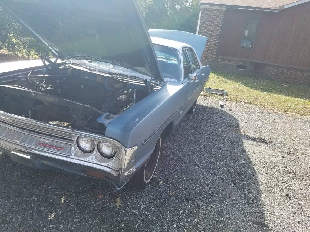

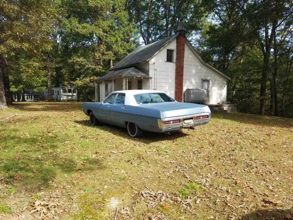

I just bought a 71 fury 3 and I'm trying to determine a little about the car and I've been able to decode most of it but I really have a question about the drivetrain codes, I know it was a 360 2 barrel with the heavy duty transmission code d32 (score for a small block 727) but there's a code I can't quite decipher. M182. I have no idea what it is. Also, my car has an 8 1/4 which I thought was odd considering that it had a 727. I can't see that there's any code regarding the rear gear, I suppose I'll have to physically look at the rear end for that.
All in all, it seems like originally it was a pretty unremarkable car, though it was b2 blue which is nice. I'm including a pic of the tag and the car. Can anyone add to my assessment?
