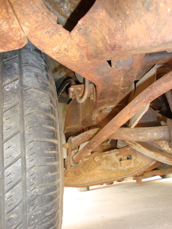

So, just what does "bent" look like? My strut rods are both bent, and I figured it was either from a bad trip behind a tow truck, or from the fairly immovable object that it encountered at some point. Since the sway bar attaches pretty far back on the strut rod, it doesn't seem like it would be particularly prone to bending - but the bend is easy to see even in this cruddy pic:
235_70_16_V45-21 by clair_davis, on Flickr
I'm about to get the subframe straightened out at a frame shop, and will do the front suspension at that time as well. I really don't know as much about this front end as I'd like... All my A-body experience don't mean squat here...
