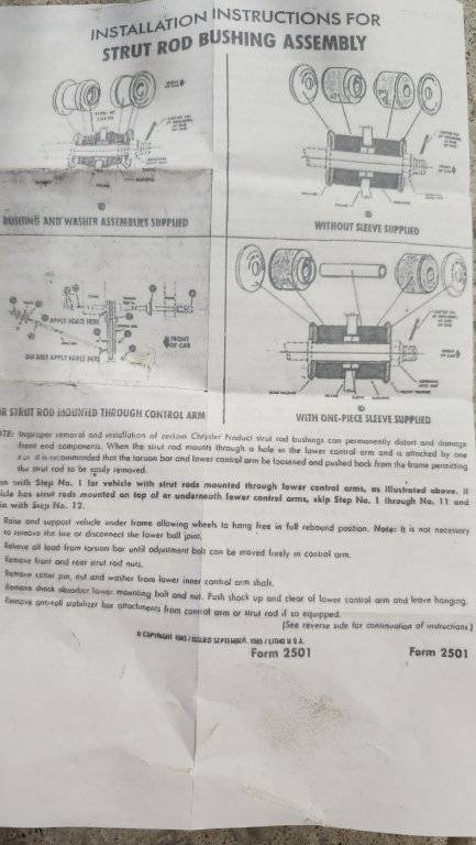

Sleeveless strut rod bushings
Maybe they discontinued the K7019A because the K7039 would work as well. I am positive that if Craig is selling them for the 66 300 then they are correct for the car. I think what has happened is someone back at Moog has put 1 wrong rubber in the box and I need another sloppy one so I can use the original sleeves.

Just measured, 47". I think Craig sold me the right ones, just something got packed wrong at Moog.
