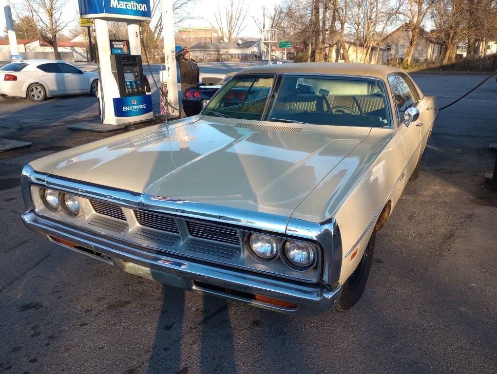

Finally got my dream survivor 69 Polara, query about keeping survivor or doing mods
Thanks to everyone for their candid opinions. Looks like a clear consensus to leave it as it is. And I also agree with the excellent advice that, at a minimum, drive it for a year before doing anything. At this point, I really don't think I will do any mods. Also thanks for the various tech observations.

Good score, nice to see a 4-door hardtop Polara. My two cents: leave it alone, and no gas caps on the paintwork!
