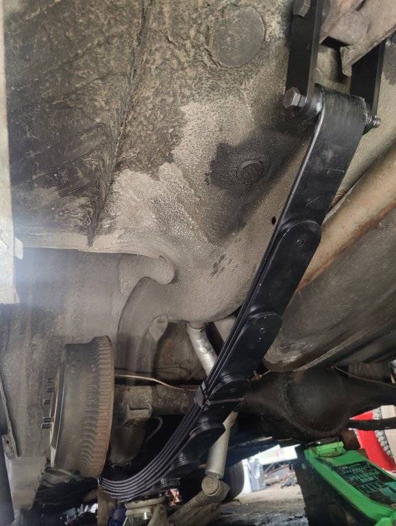

Overall it went well. All the parts an pieces looked perfect, were finished perfect, and were wrapped like they were your grandma's china. Almost everything fit perfect with the exception of the pins on the leafs being about 25 thou too fat for the sway bar mounting plate and the axle hole. This sucked to learn when the first leaf was hung so I had to file it in place. For the second I was able to measure and plan ahead.

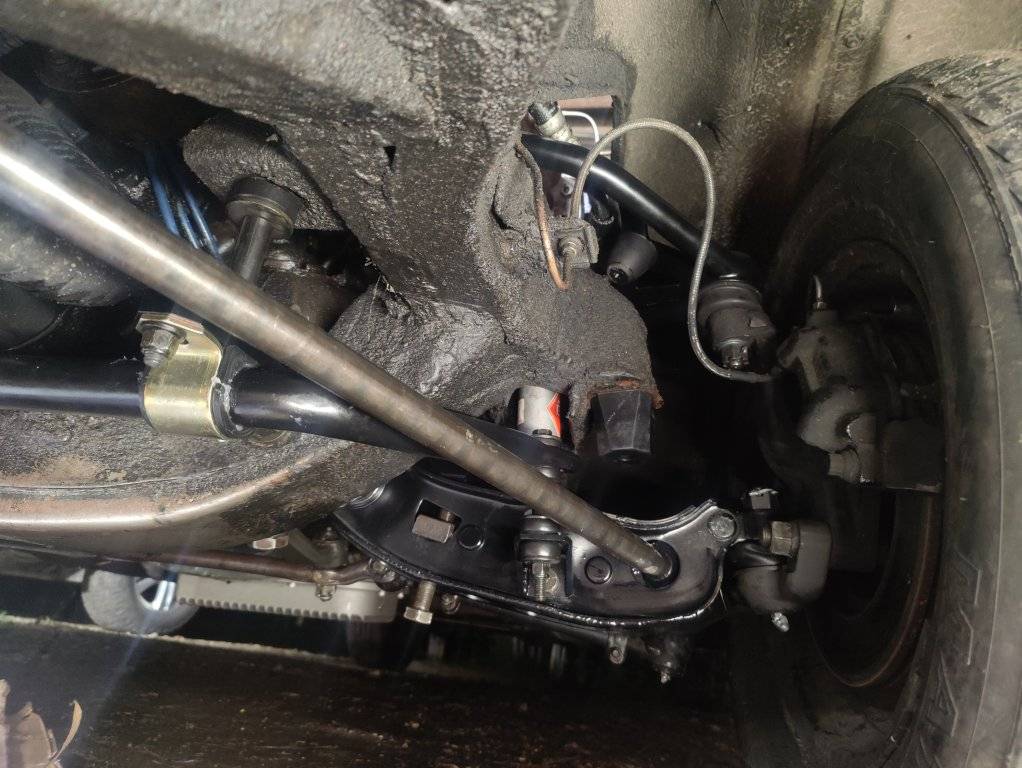

I didn't expect the front sway bar to attach differently but once I had the instruction it went smoothly. It looks more stout that stock and my stock strut rods had bends where the sway bar attached.
The nylock nuts on the pins are a bit of a trick to get the pin to not rotate with the nut. The first one went great but I still think I might need to grab a couple jam nuts to ensure the second is actually as tight as I want it. I also found out that due to my exhaust routing the torsion bars have to go in from the front so make sure to do that before putting the LCA on. lock rings for the back of the torsion bars were a bit too small so I reused the factory wire ones.

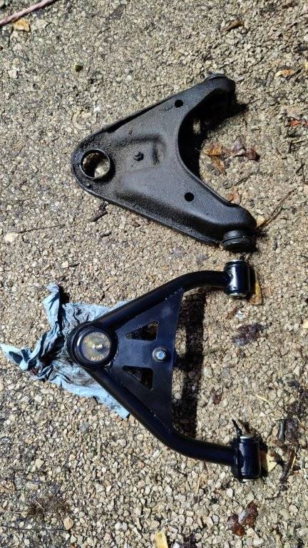

The tube UCAs went quickly and easily. A little tapping with a rubber mallet to help guide them in line for the bolts and there they were.

Any pictures of the install?
Not in any particular order but here's what I've got. There were two more but it wont let me upload
