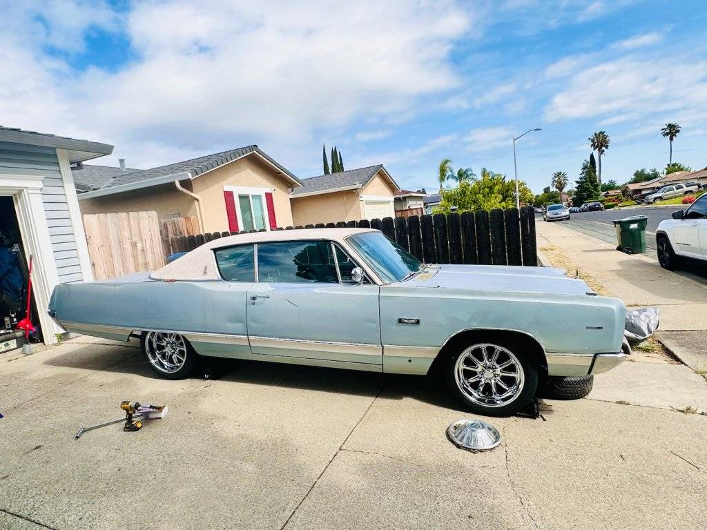

hello, I'm David. i own a 1967 Plymouth fury vip that i inherited from my grandfather. the car has always been in my family since it left the dealership. looking to restore and rebuild the motor, transmission, and replace with disc brakes. any advice as I start the tear down process would be much appreciated. motor is stock 383 super commando with a 727 torqflite. no reverse gear at the moment.

its been sitting for a good 15 years. i want to do the motor right and also install new cams, carbs etc. i got a buddy who does car restorations thats helping me out with some of his knowledge and connections to parts, but also trying to do this on my own or do what i can on my own. so making sure im doing all my research before anything happens.
