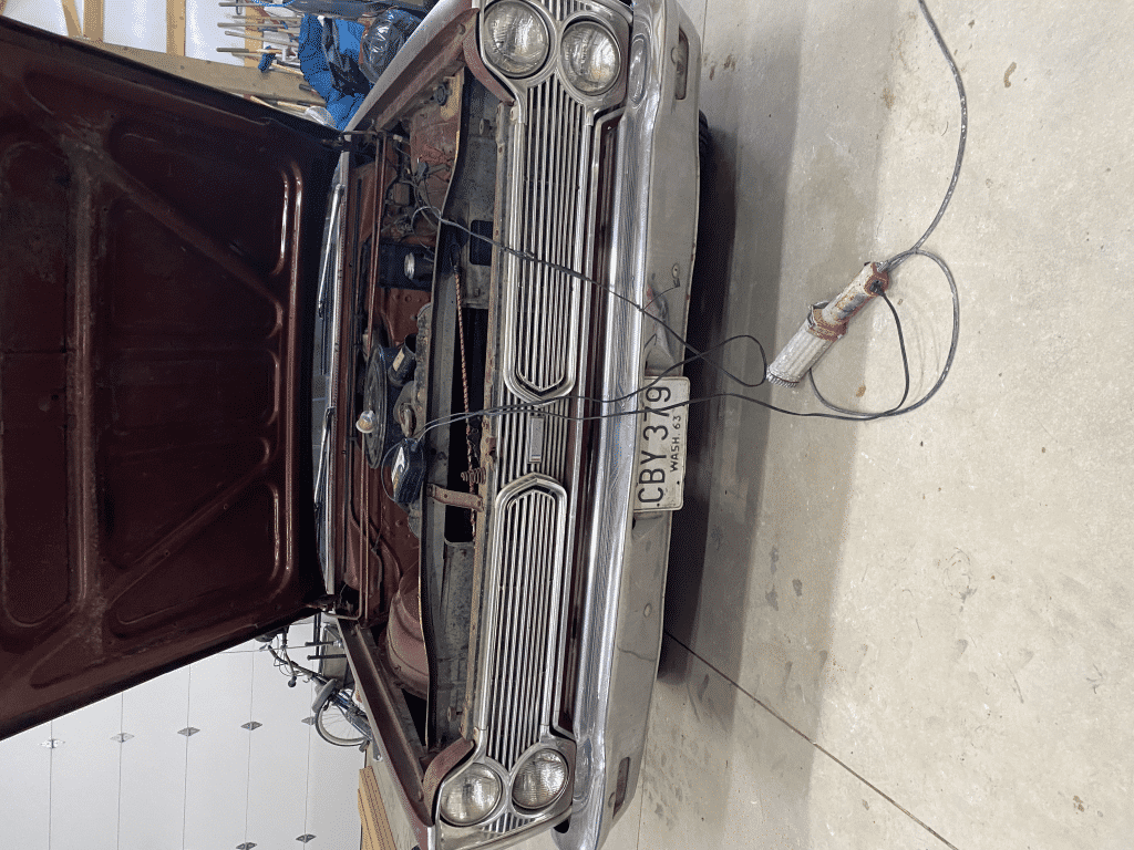

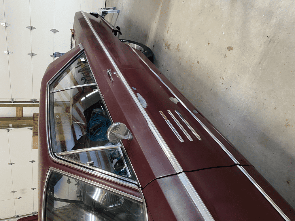

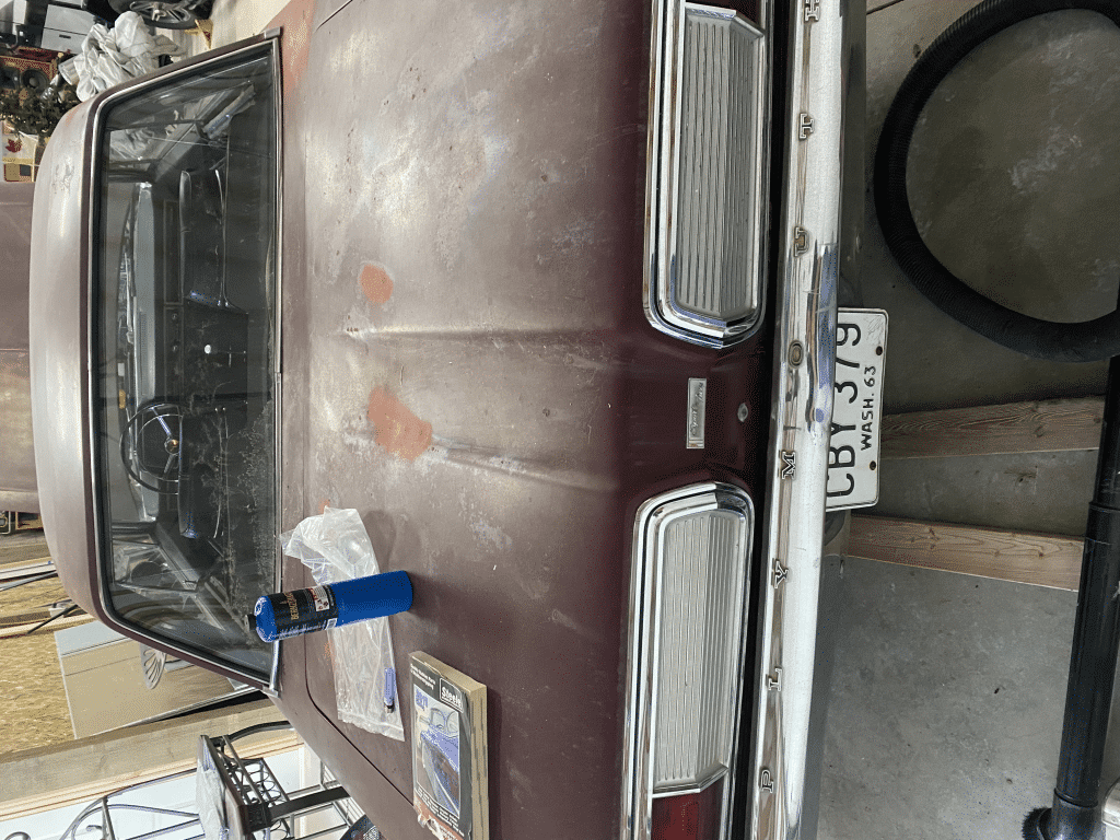

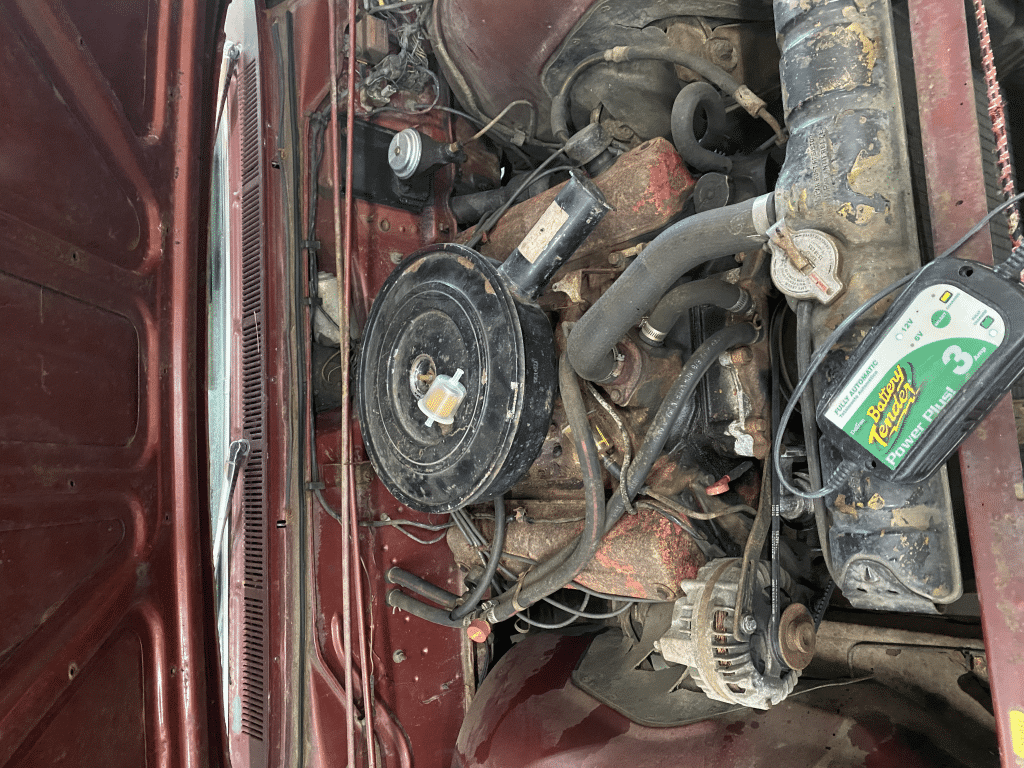

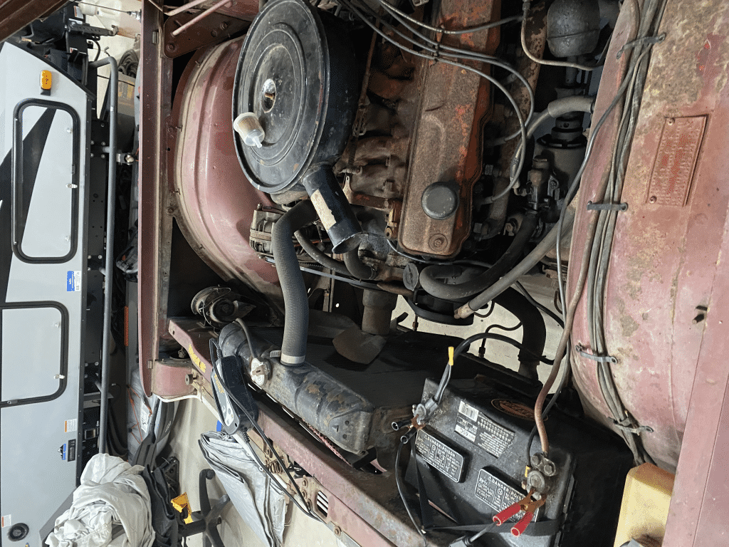

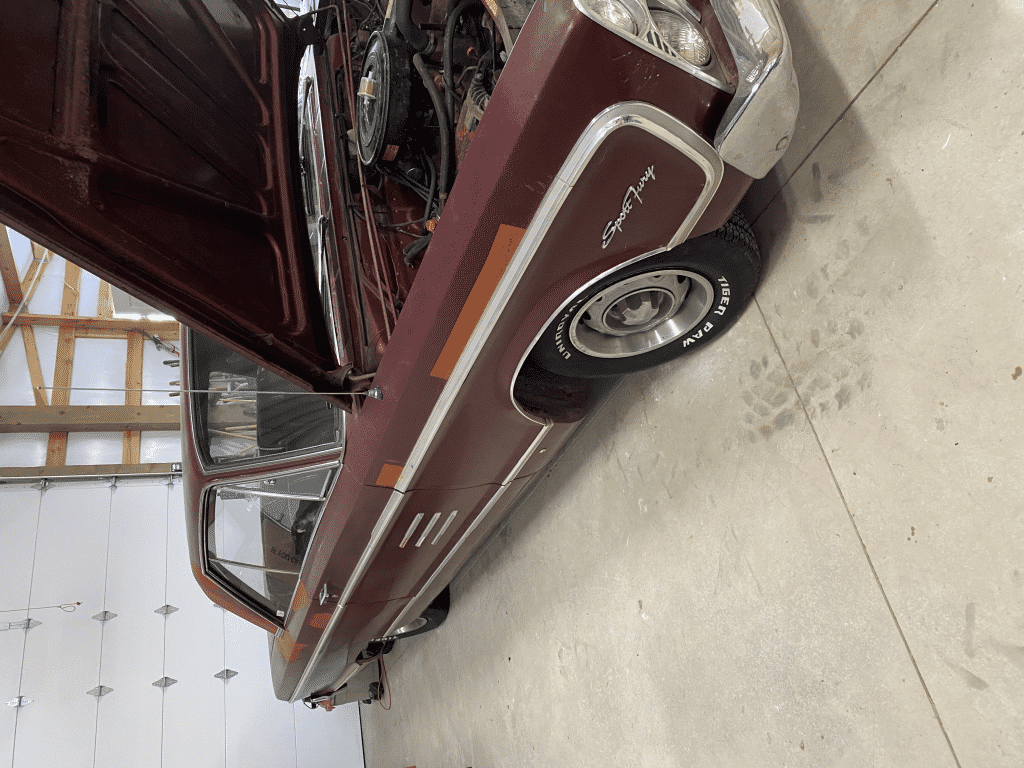

Wow what a great response from all of you. I have added a few more images of the car. Sorry I am having some trouble rotating the images. Great feedback from all of you. I think I am set on the 360 Stroker motor for a few reasons. As mentioned I dont need to change as many things to make it work. For me I want something that will perform, will be somewhat unique to an already unique car and with a rumble that will make the car special. No I dont plan on being at the strip every weekend, and no this will not be a daily driver however I want to have something that reflects what I want the car to be when I am done. It wont be a show car. I dont want to make it a 100% original car however I do plan on changing the color to a light blue. I know this involves more work however the current color is just not my cup of tea. I bought the car with an idea of what I wanted it to be and maybe that will change over time and once I start to dig into it however at the moment that is my vision. I want to add larger wheels and tires and make it perform. These cars are under appreciated and that I why I chose this car for a resto mod. We have all seen a million Camaro's and Mustangs but I wanted something unique. I was at a car show not that long ago taking to a guy about his car and mentioned what I was going to do and he had never even heard of a Sport Fury. I punched him in the nose and kicked him in the teeth but he was a chevy guy so I was not expecting much anyway. Ha. I have recently retired and looking for an excuse to be in the shop, versus telling my wife I am working in the shop however just drinking beer. Now I have a legitimate reason to be out there, and drink beer. I plan to do as much of the work as I can myself only lookin to maybe have the motor and trans done and the final paint. Other than that its on me. I don't have an unlimited budget however this car will not be a trailer queen and I plan on driving it and feeding it the onions on occasion. I will be leaning on your guys for all of your knowledge and experience and I will do my best to share my progress along the way. I am almost finished with building a craft room for my wife inside my shop so once that is done I will start to work on the suspension and brakes making sure all my systems are solid before removing interior, engine and then addressing the body issues. With such a great response from all of you already I cant wait to see where this leads me. Hopefully not to depression and alcoholism, ok maybe not depression anyway.

IMHO, it looks like you have a solid, drivable car as it sits.
My philosophy with cars like this is to give the advice of getting it reliably drivable and then going out and having some fun with it. Do small projects that won't keep your car off the road for months... and months often turn to years and years turn into the car that's all apart in the garage that never gets down.
Paint and bodywork is $$$$ as said. You'll never get any return on the investment and it's gotta be just done for the love of the car. Body shops push those cars into the corner as "filler work" which means they never get done and all the parts get lost... Find a shop that paints old cars and gets them done.
Regarding the engine... Geez... A 318 Poly motor.... Not something you see a lot and they do have a ton of potential along with a great visual appeal when the hood is open. There are a few builds out on the intrawebs for these engines. They share enough with the LA small block and the heads are pretty decent. I'd stick with that... and then you don't have to worry about mounts etc. The engine already fits! Don't forget the price of gas is not going down anytime soon (probably not at all) and the octane on ethanol free gas has been dropping... Building a killer engine sounds really cool until you realize you have to wrench on it more and it drinks deeper (read $$) at the pump. Too many cars sitting around, not driven because the killer engine either needs work or that $5 per gallon at 10MPG bites the wallet so hard that making it to "cars and coffee" isn't as much fun as it used to be.

Hey! Welcome to the asylum. You said you were drawn to this car, because it is unique, and it certainly is - especially since it has a Poly 318. That makes the car stand out and makes it really unique. If I was you, I would seriously consider keeping the Poly and make a few common sense mods to improve performance. You wouldn't need to spend a whole lot of money to make that Poly run as well or better than some of the alternative engine choices already mentioned. Here is a video of a guy who appears to have almost the exact same car and engine you have, and he discusses at some length what he did with it:

That’s a solid looking SF and a lot of solid advice is coming your way Ian-Secret Alien Man.
The Poly is one of those unique animals, and I agree with others, that itself can bring attention when perched in the SF’s engine bay. Dual quads are an option too.

Thanks for the feedback and for adjusting the pics. I have thought about a 440 as well but your point of a different trans, drive shaft, radiator are all factors. A new rad will be a good idea no matter what, my trans will have to be rebuilt anyway so it may be a better route. Not sure of what is involved short of motor mounts, trans and driveshaft? From a cost perspective I don’t see a big difference considering everything on the motor is tired and I would not reuse. More pics soon. Thanks for the info
