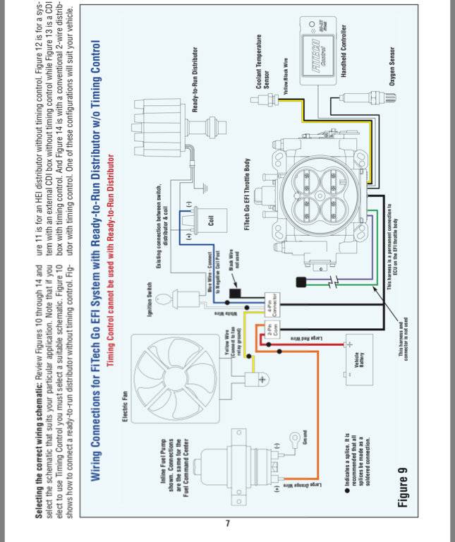

No timing control, just fuel. Okay, isn't the negative wire from the 2 wire distributor the pickup? Its connected to coil negative, and there the tach signal comes from!? Did i wire that up wrong????
Depends. Did the instructions tell you to wire it to the coil or the pickup? If it said the pickup then you did it wrong.

Instructions said to coil. However, I am going one problem at a time now. Changed my vacuum advance to ported and thats already made a difference.

Ok i dont seem to understand this then. Isnt the two wire distributor pickup going to coil positive and negative? Where else would i get the tach signal from then???
Breezing through the fitech install diagrams and without one for an HEI setup with an external coil, I would assume it acts as a 2 wire ready to run distributor. I’m not at all smart on HEI ignition, but does the external coil have a tach out terminal?
