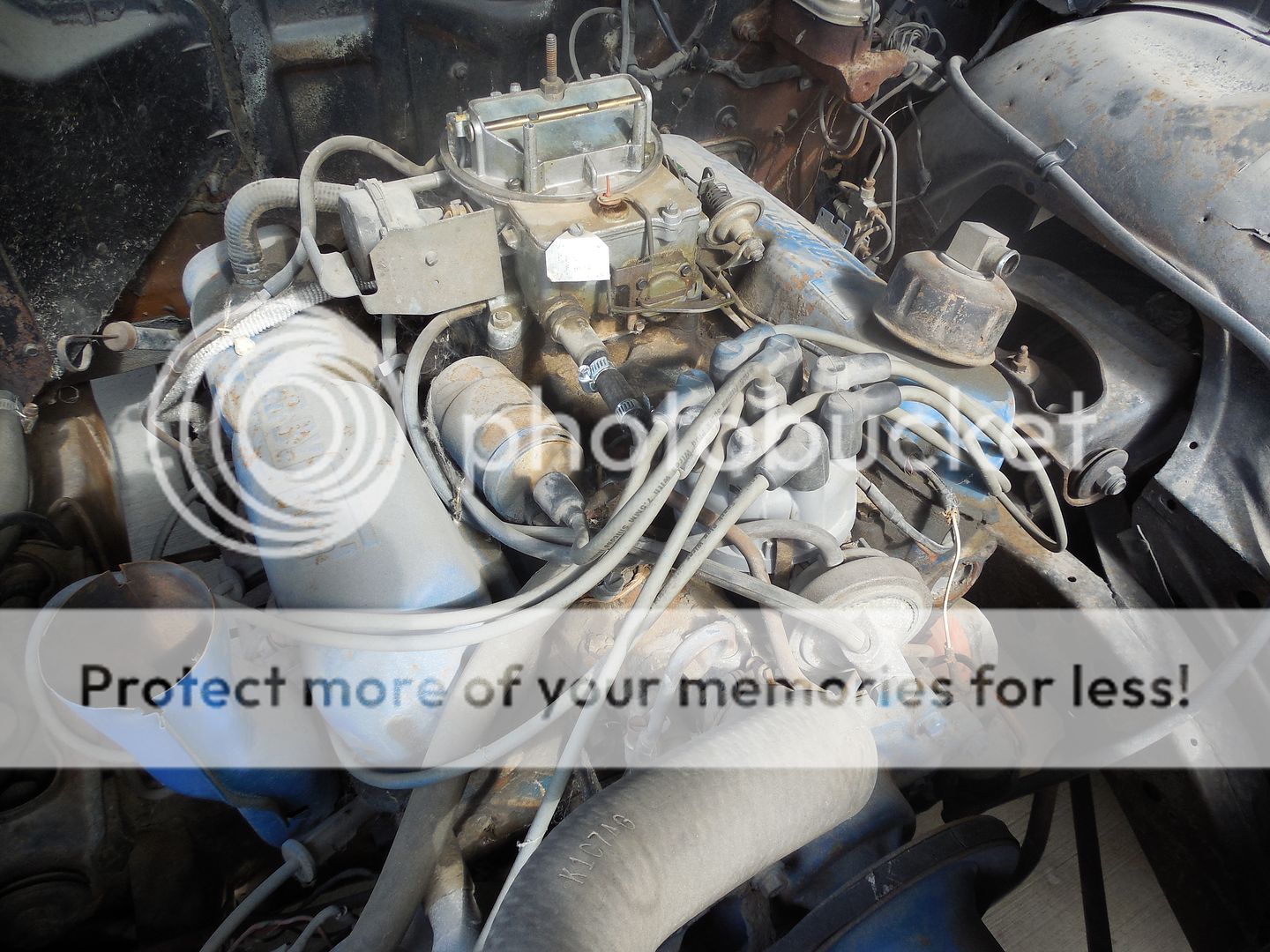

I replaced the entire fuel hose on my '70 Mercury about two years ago. I have owned the car since '94. I wasn't having any issues other than the end at the fuel pump having some oil and gas on it and becoming a bit brittle, but I thought it was probably a good idea to replace it. Rather than just replacing the last ten or twelve inches, I decided to do it right and replace the whole length. After removing it and looking it over, the rest of the old hose seemed fine, but now it has all new hose on it.
Ford didn't use any steel fuel line in the engine compartment of their full-size cars of that era (except from the pump to the carb). As you can see, the hose connects to the steel line down in front of the firewall, behind the inner fender and then runs up over the fender to the fuel pump. The car in the pic is a '68, but my '70 is the same. I think they were the same from '65 -'73 and maybe later. Anyway, my point is that a good quality fuel hose should last a long time, several years, not just a few months or a year.
