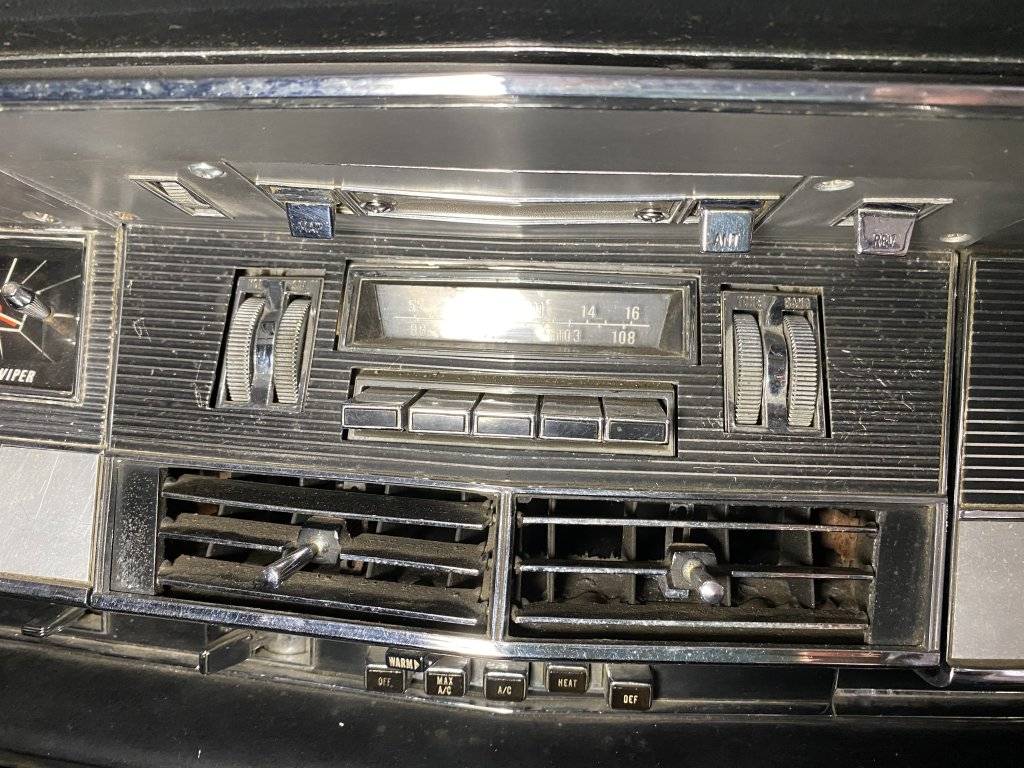

Post a pic of the radio - is it the search tuner, or regular AM/FM unit? What did your Newport have originally?
THANKS for posting this - I was (or, had been) wondering where the switch was for a '67 - would love to have this in my New Yorker, doubtful if I'd ever actually find a switch, though.........Not sure if 66 and 67 are similar but the reverb unit (the box) goes under the rear seat and is screwed onto a bracket there. In my 67 300 I have the AM/FM radio and the reverb unit is turned on with a toggle that is just to the right of the power antenna switch. See photo, the toggles left to right are map light, p antenna and REV for reverb. Cam Shaft
THANKS again for this MOST helpful photo. Usually with reverb also comes the rear speaker. With rear speaker comes the front to rear, or "fade" switch. I THINK in '67 (and maybe others) the switch for this is the thumbwheel to the left of the MAP light switch?Not sure if 66 and 67 are similar but the reverb unit (the box) goes under the rear seat and is screwed onto a bracket there. In my 67 300 I have the AM/FM radio and the reverb unit is turned on with a toggle that is just to the right of the power antenna switch. See photo, the toggles left to right are map light, p antenna and REV for reverb. Cam Shaft
I don't have any pictures of it yet but it is installed in the dash and working wonderfully. I decided to hold off on installing the reverb for now until I have the required trim. I may opt to leave it out and use a line level converter then attach to the aftermarket setup currently installed in the rear deck.Post a pic of the radio - is it the search tuner, or regular AM/FM unit? What did your Newport have originally?

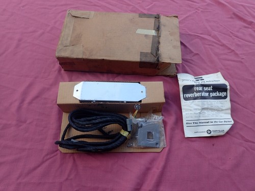

Looks like I missed it. Based on that sale price I might need to put mine up for sale...FYI:
1967 MoPar rear seat reverb package, NOS! 2820781 Dodge Plymouth Chrysler radio | eBay
Find many great new & used options and get the best deals for 1967 MoPar rear seat reverb package, NOS! 2820781 Dodge Plymouth Chrysler radio at the best online prices at eBay! Free shipping for many products!www.ebay.com

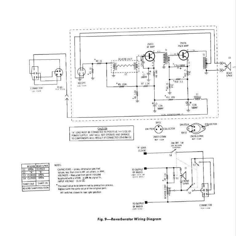

That's the place I was looking at if I decide to go stock. I have a single dash speaker so the 6x9 10ohm ought to work. I assume being a transistor amp these wont be upset by having no load? Now I'm wondering if line level converters have a dummy load I need to worry about being 4 ohms...Most definitely, a search tuner was available in 66.
If your original radio wasn't a search tuner (didn't have a foot switch or search bar), and your new radio fits, it's a non search tune unit of the same shaft spacing family. Good!!
I am pleased to hear it's sounding good.
FYI - in case you didn't know, with the reverb and/or plain rear seat speaker option in 66, the front speaker was 6 ohms, and the rear was 10 ohms. It seems you already know about the concerns of too little ohmage ruining amplifiers, so you need to make sure hat you get the right speakers.
2 x 10 ohms would be OK, but 2 x 4 ohms would burn up your radio's amp. 6 + 10 would be to spec.
Single dash speakers were 10 ohms I believe.
New correct ohmage speakers can be bought from Electro-Tech, found here:
Classic Car Speakers
I bought one for my 66 and I could not be happier with how it performs with my rebuilt search tuner.
Do you have any experience with the speakers from Electro-Tech? Can they get loud without damage? I'd like to get as close to hi-fi as possiblle and after hooking the radio to a Paradigm speaker in the house I know it has the ability to sound amazing and get loud with something decent.I don't know about the line level converters... I think you're all right with no load, but again, I am not 100% sure, and therefore I tend to always hook them up to speakers.
