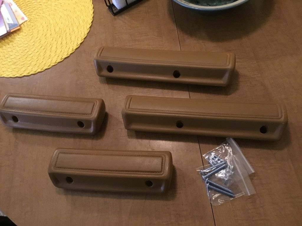

Mar 29, 2018 #3 Shamu70 Member Joined Jan 17, 2016 Messages 197 Reaction score 242 Location Illinois Here you go. Um, I haven’t looked yet, but are they mounted with wood screws like these?
Mar 29, 2018 #4 azblackhemi Old Man with a Hat Joined Nov 13, 2010 Messages 8,725 Reaction score 12,971 Location Waddell AZ Yes they are.
Mar 29, 2018 #5 300rag It's Not Going to Shift Itself Joined Dec 4, 2010 Messages 14,302 Reaction score 24,556 Location Cochrane, Alberta, Canada Shamu70 said: Here you go. Um, I haven’t looked yet, but are they mounted with wood screws like these? View attachment 176467 Click to expand... Not to be picky, but those are sheet metal, not wood screws, and fasten to the inner door steel.
Mar 29, 2018 #6 MrMoparCHP Old Man with a Hat Joined Aug 9, 2013 Messages 6,069 Reaction score 6,290 Location Lompoc, CA I had to use my original screws as the ones they gave were short. Alan
Mar 29, 2018 #7 Big_John Illegitimi non carborundum FCBO Gold Member Joined May 21, 2013 Messages 21,844 Reaction score 33,099 Location Marcellus, NY I bought a whole bag of those screws in stainless steel for less than anyone was selling "Mopar armrest screws" for.
Mar 29, 2018 #8 68PK21 440.6bbl Old Man with a Hat Joined Nov 29, 2017 Messages 8,892 Reaction score 8,258 Location Dodge City FL. And I seem to remember that the screws screwed into a plastic insert correct? On armrests that had pulled out and stripped out the plastic would require a larger diameter screw from the local hardware store for a easy fix.
Mar 29, 2018 #9 MrMoparCHP Old Man with a Hat Joined Aug 9, 2013 Messages 6,069 Reaction score 6,290 Location Lompoc, CA There should be a metal clip in the door that the sheet metal screws go into. Alan
