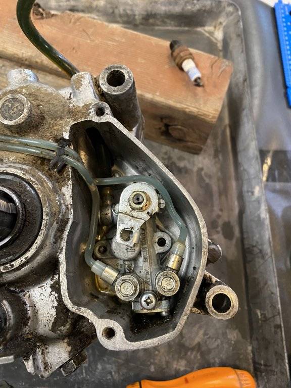

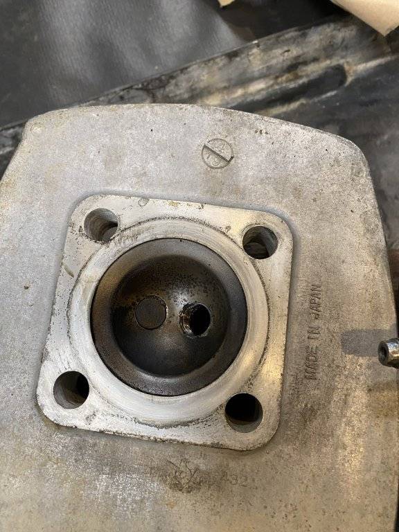

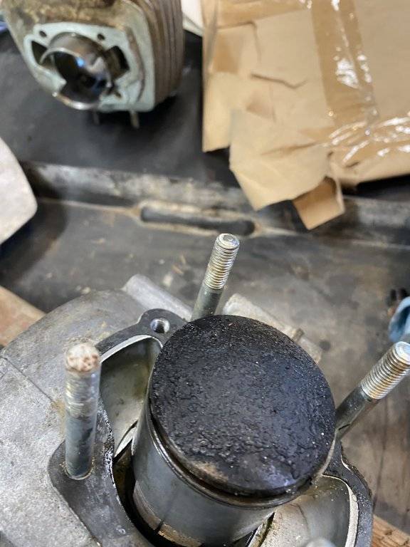

The lack of carbon build up and nice bores lead me to think good oil .The old Suzuki’s have a pretty robust oil injection system one line lubes the piston and one the main roller bearing. As the throttle increases the pump pressure and volume increases. I am sure we used whatever 2cycle the Cenex carried.
