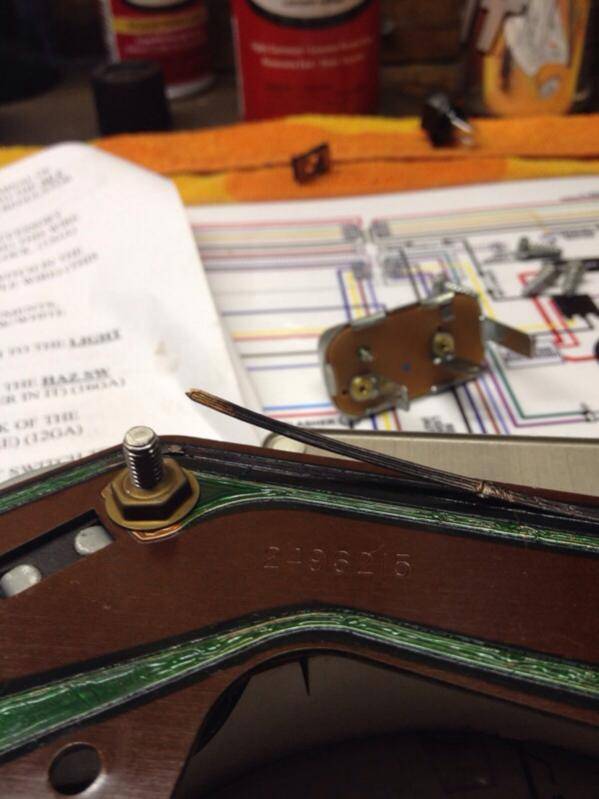

Found a burnt trace in the power supply to the gauge. Getting a lesson in soldering tomorrow from my mom who used to be an electronic engineer :)

Does anyone know where I could find that tiny gauge wire that's wrapped around the heat bar thingy in the gas gauge?

If you need the wire that's actually wrapped around the bimetallic bar portion of the gauge, the wire you use needs to be resistance wire like Nichrome, which heats up when current runs through it. I had to repair my fuel gauge because of a burned wire but it wasn't on the actual bimetallic bar so I just used some strands from some stranded wire laying around. Hope you can get it working.
I figured I'd save myself the headache and opted to finding one on eBay, luckily. But maybe I'll try to repair the broken gauge that way I have a spare :)
In other good news, mom came over today and helped solder the burned traces on my instrument circuit board. Saved me $200. Hope it will last.

Awesome! Yeah I got everything working in my dash even the lights are brighter!!
