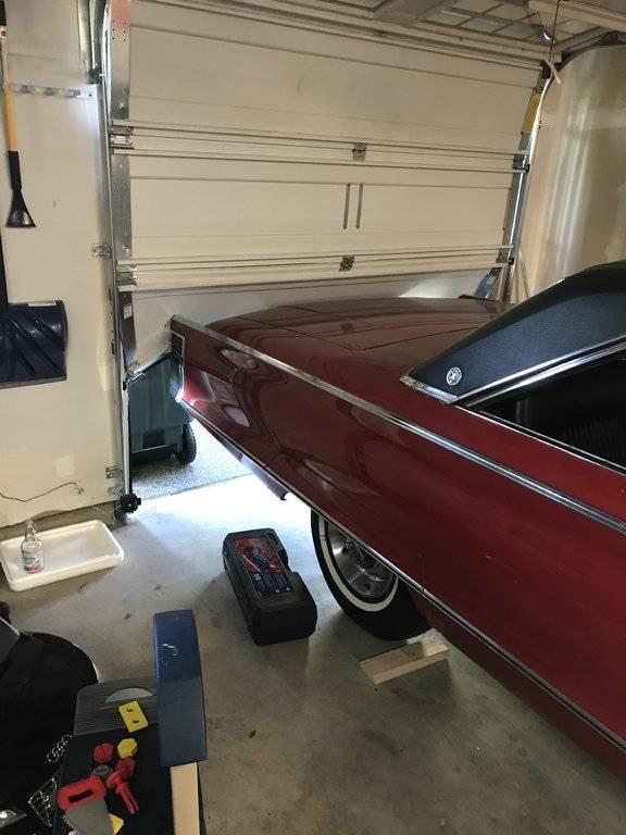

Oh... and lesson learned yesterday... Be sure the car is in the garage far enough that the door closes when the car is jacked up.
I learned a lesson too.....
That's an o **** moment right there! How bad is it? Guess 2x4's just don't cut it as wheel chocks...
...look like your mechanic has the intercooler out of that audi tho, you may have to get in line for repair
Yea the Audi mechanic has a combo of bad hours and a short attention span so it'll be a while.
Oh crap! Did the car roll into the door, or did the door come down on the car?

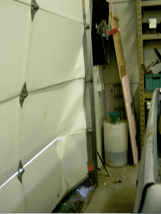

Funny story, I had just finished all the front end work and pushed the car out to clean. When I pushed it back in I forgot to put her in park. I still needed to fix my kickdown linkage so instead of driving up on the ramps I said "screw it, I'll just jack it up and lower her down." Well you know when you lower a car down with a jack it goes down at an angle and I 100% forgot. She landed half on the flat and rolled right down and through the door. 2x4 of course was a joke. Again I have a real chock on the other side.....not under the wheel.
The door bent right back and you can't even tell from the outside and the car wasn't even scratched. Nothing hurt but my pride.....

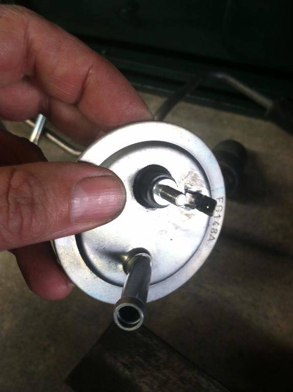

Got the new sender on Friday (I love Amazon Prime!) and the first things I did was compare it to the old one.
Two differences jumped out, the connection to the rheostat is a wire and the float is plastic. I checked the resistance and found it to be 10 ohms full and 77 ohms empty. All looks good...
I decided to eliminate any ground problems and I soldered a male connector on mounting face.
That connected to an existing ground wire that was used for the old sender.

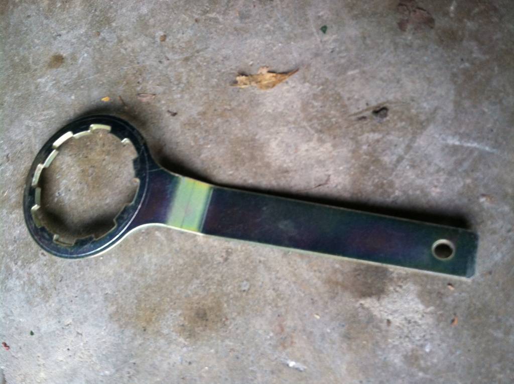

I had a wrench that I bought years ago that made things easier.

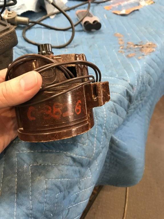

I bench tested my gauge with my Chrysler C-3826 test tool. Well my homemade version. The fuel Gauge and temp gauge were accurate. When I put in my replacement sending unit it seemed to read low. When I replaced my fuel tank, tested the sender by hooking it up out of the tank and going stop to stop. It t was also making the gauge go to full. What I don’t know is if the float sits all the way to the stop when empty and all the way to the top stop when full. I didn’t check it again after it was assembled and put gas in.
