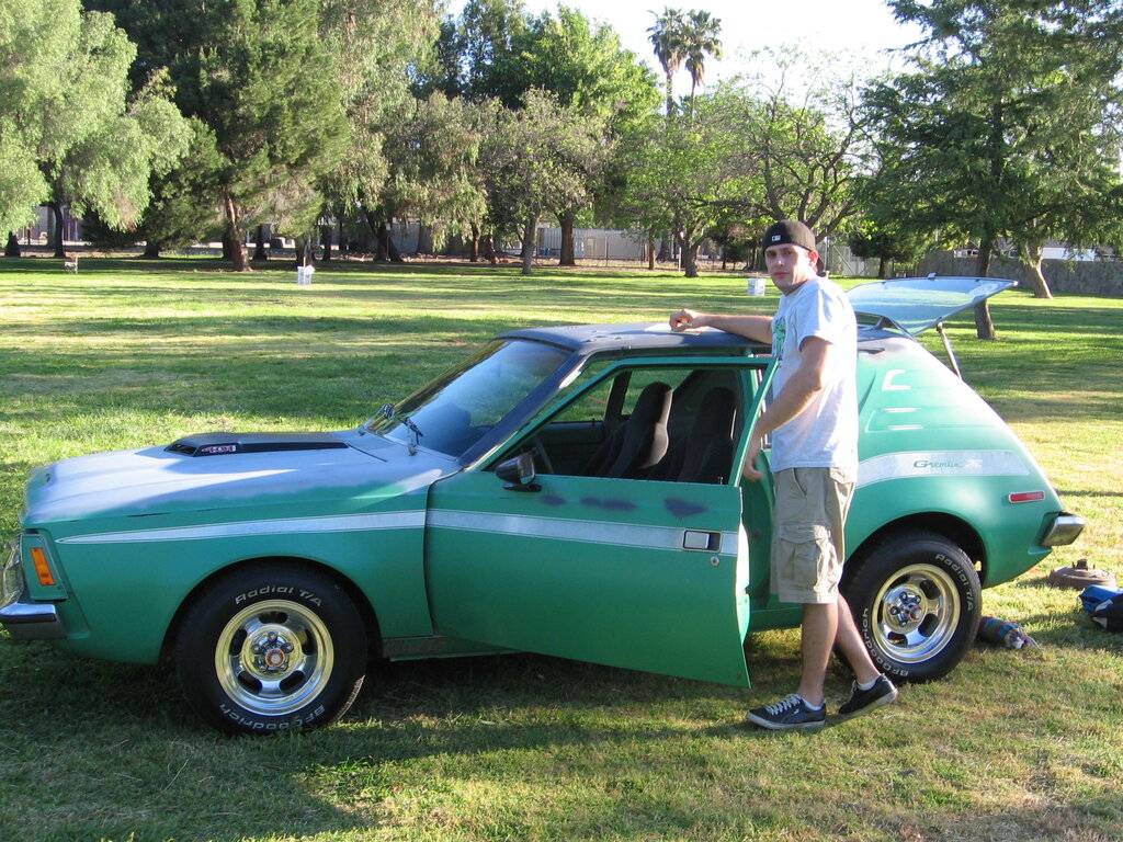

I know that's an issue for many a disk brake set-up. However, it hit me last week that I converted the Gremlin to disks and am running 14s on it with no problems.

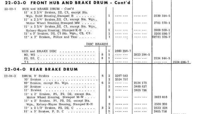

My 65 Fury cop car has 11 x 3 all the way around. This is what I used for the fronts. They got a bit more expensive, but appear to be still readily available. They will work.

Mine were made in the USA. Bought them a long time ago. I got NOS on the rear. Those cost me $275 plus shipping in 2001. I did find a third one in 2006. Have that as a spare. I was never successful in finding 11 x 3 front NOS ones. I tried - did find 11 x 2 3/4 but not 11 x 3.

Secondly, on Isaiah`s vehicle , to whom I was responding to in this thread, there is --- NO --- question that his car has ONLY 11" x 3" --- as opposed to the 11" x 2 3/4" that came on Dodge and Plymouth "C" body --- but NOT --- Chrysler Newport, New Yorker, and 300.....
Thirdly, Police Cars, Ambulances, and the Heavy Duty Tow packages came equipped with 11" x 3" Rear Brake Drums --- that I have known for 50 years --- but that has no relevance in this thread, as Isaiah is interested in Front Brake Drums ONLY -- and his car, of course, has 11" x 2 1/2" Rear Brake Drums....
