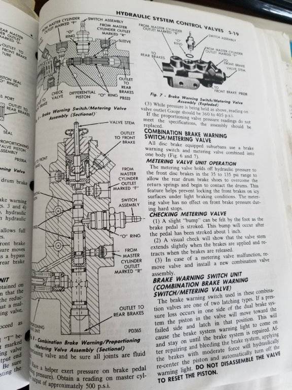

This is the pv I have. BWS/MV,right?
I don't have a factory service manual, yet.
Took the pic from another thread.
Thank you. I sure need that book.
Ok, so out it is. And it specifically mentions the lock out while bleeding.
Well, yes and no. I need this thing to move so I will try to figure out something to pull it out and hold it out for the bleed time.
I'm hoping that the issue was all caused by the leaking top cover of the M/C and after bleeding the system the check valve will function as it's supposed to.
Hopefully.

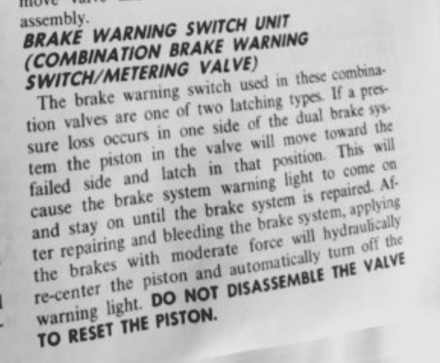

I'm late to the "party" here, just to throw this out there, one time I lost my brake pedal on my '71 Polara, due to a bad master cylinder. Replaced the master cylinder, had the same problem you are having, nothing coming out the front. Asked an A body guy I know, he told me to push that little dick in (I believe he called it a reset button). He said it comes out when it senses something wrong with the system (which there was), worked for me! Best of luck!
Thanks for the thought. We discussed the little dick earlier in the thread.
You are the first to state that when the check valve has done it's thing, it's out of the Brake Warning Switch/Metering Valve BWS/MV.
So it if's doing it's thing correctly, it is towards the inward position.
You mentioned your brake light was on right? I think your problem is here. As I recall, the little dick is always at around that distance, it may just need to be pushed in and allowed to pop back out. Maybe try the moderate force method outlined above?
I have tried in and out with no change.
