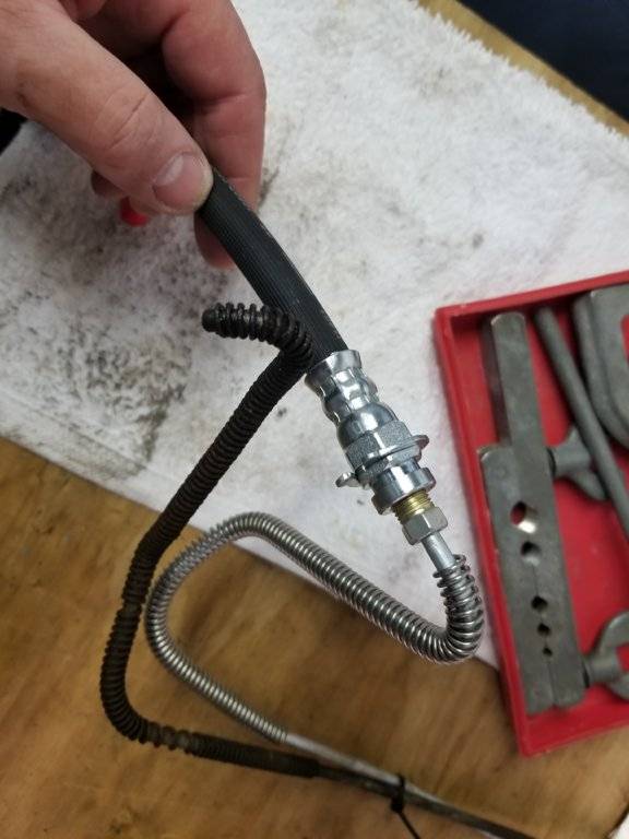

I used the same front & rear rubber brake hose lines on the New Yorker and the fittings worked fine connecting the brake lines to the calipers and to the tee on the rear axel housing.

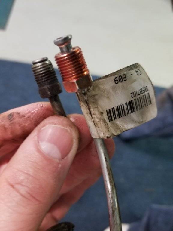

Using the hard brake line for the passenger side of the 73 Chrysler kit from the Right Stuff 4 piece kit (HFB7102) the connection to brake hose was fine, but the fitting to the Brake Warning Switch/Metering Valve was smaller.
Had to cut the line at the this end, bend the line after replacing the new fitting using my original fitting, then used double flaring tool to make the seat right, then connect to the BWS/MV. (This is a PITA to do as there is little room to measure for the correct bend, and because the opening for the front right brake line in on the bottom of the BWS/MV).
The brakes have held up fine since I've been driving the car.

The fitting to the BWS/MV was the wrong size, as mentioned earlier.

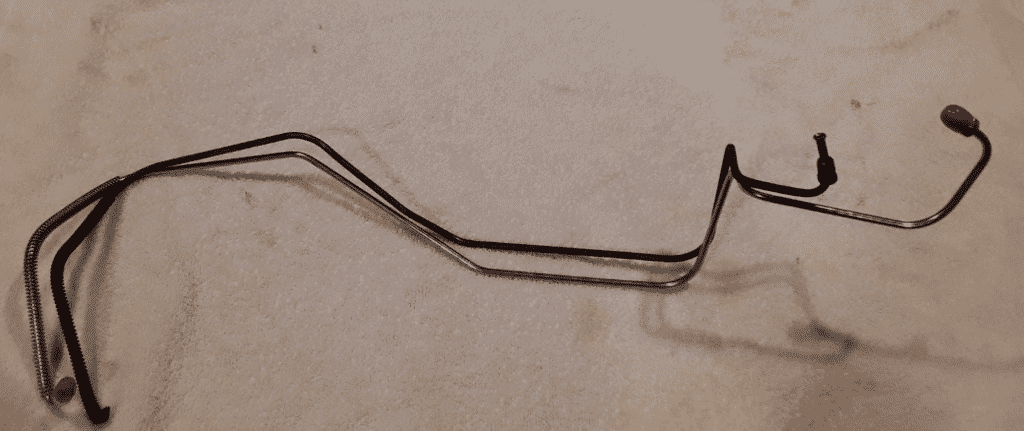

Tim, I checked all my 71 thru 73 C bodies (all with disc brakes in front) - that is 2 1971 Monacos, 2 1973 Monacos, and 10 1971 Chrysler 300s/New Yorkers and every single one of them does not have a line like HFB7301 for the left side disc brake that was listed on your order for your 71 New Yorker. I talked with Stephanie today at The Right Stuff, and she was helpful by sending me a photo of HFB 7301 and the ones I have had to use on all my cars in the same photo for comparison. Could you verify for me which of these two lines you actually installed and whether you had to modify the fitting and/or end of one of the lines?
I need to order a set of correct lines for Michel for Medina, and I need to know which one to order for it (I will talk with Wyatt later to see if he can tell) so he gets the correct set the first time.
So which one of these lines in the photo below is the one you used successfully in your 1971 New Yorker for the left side front line - and let me know if you recall making any modifications to it? The line with the red caps is HFB 7301 and the other line is the sample line from one of my cars used for making the one I needed for all 14 of my cars. I have a hard time believing that you would have something different than all of my cars?
Thank you.
