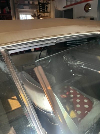

The trim/molding on the passenger window/glass is not secured to the glass and slides down.
What is this piece of trims official name ?
How is it secured; rubber gasket, adhesive, pinched ?

I could give some questionable advice but I’ll refrain to avoid the red X. Following, since I have the same issue.
They make a type of fabric that looks like a combo of fiber and rubber that looks like tape but it is not. It wraps around the edge of the glass then the trim installs over it. I had to do it on my rear driver side window. If you take the glass out and take it to a glass shop they can reinstall that trim to the glass. I did mine myself but it was a little unnerving because you have to tap the trim on the window with a rubber mallet. BTW this has to be done with the glass out of the car.

You can just glue it back on. Try E-6000 glue or 3M weatherstrip adhesive. Just clean it with alcohol or something like that first. IIRC, I used 3M weatherstrip adhesive on mine.
The tapes would work, but I doubt if you'll have enough space.
