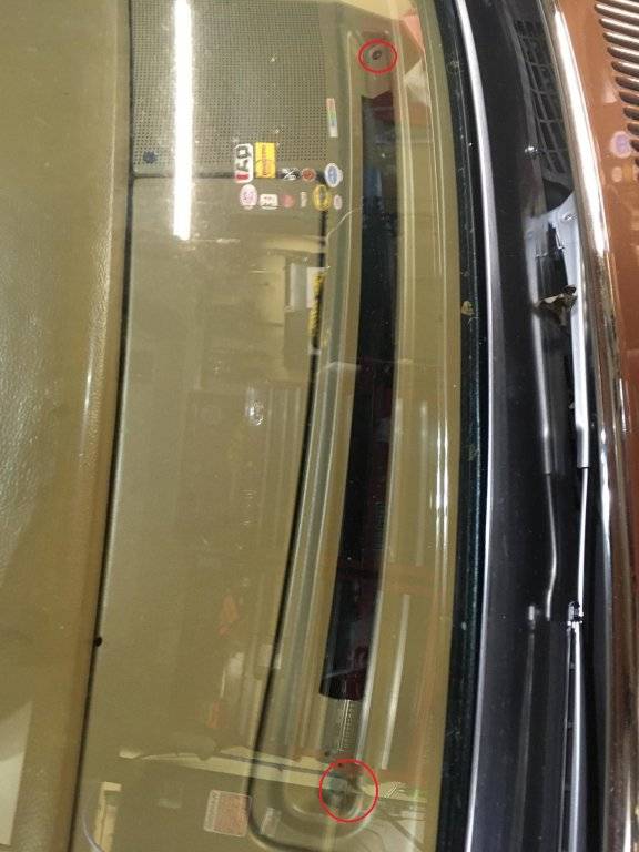

dont see any screws for the center cover. left and right yes
Pardon the reflection.
7 screws total.
3 in first picture
2 in second, right side shown... Lather, rinse, repeat for left side.
