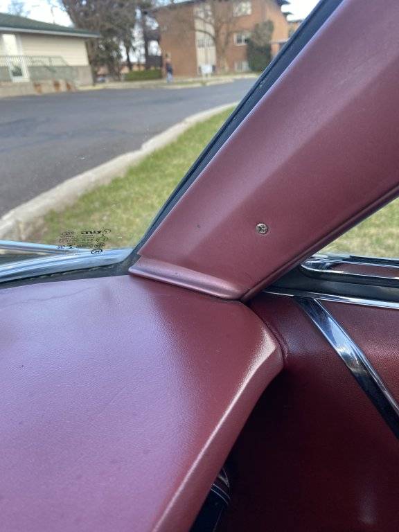

Are these trim pieces installed correctly, sitting on top of the dash pad? The windshield has been replaced at some point and I’m just curious if they put it all back together correctly or not. Thank you.
Yes, that is correct. The trim that goes under the longer trim does NOT go under the pad. It also has a slot for adjustibility under the longer piece's lowest screw.
