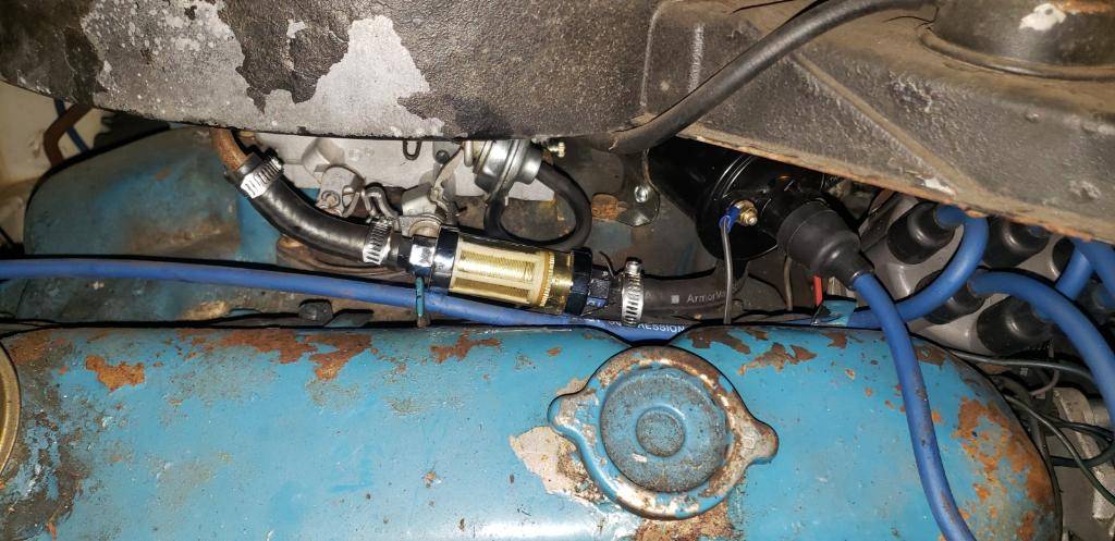

I've been researching, do I need to prime the carb? The car hasn't been started since beginning of the year so it was sitting. New battery so the car is cranking but no gas getting up into the filter between the pump and the carb (mechanic put one of those plastic see thru one in line). Thus no gas getting to the carb.
remove the inbound line to the pump and see whats doin there. if its stinky old gas, or barely any comes out, etc., its ungood.
there is metal fuel line mostly except there are rubber pieces at the fuel sender and entrance exit going thru the frame. change all these rubber pieces out with new FI rated rubber fuel line from vatozone. the mechanical FP is a puller it creates negative pressure to draw fuel. this will collapse rubber fuel hoses if they are old. this will also pull air if there is a pinhole along the length, so again no fuel draw. lastly, vacuum = vapor lock (but you are not there yet).
you can unhook the line at the sending unit and at the FP and blow air thru if you have a compressor. but just change out all the rubber lines for sure.

What happened to try not to die? Thanks for the info. I will check the lines. I put 5 gallons of new gas in. Right now the fuel line from the pump to the carb is new. Put in a new gas tank last year so that shouldn't be mucked up at. Once again thanks for all of the help.

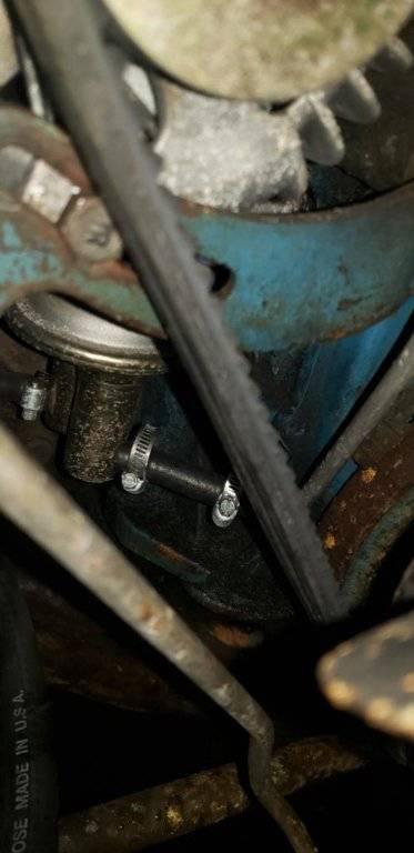

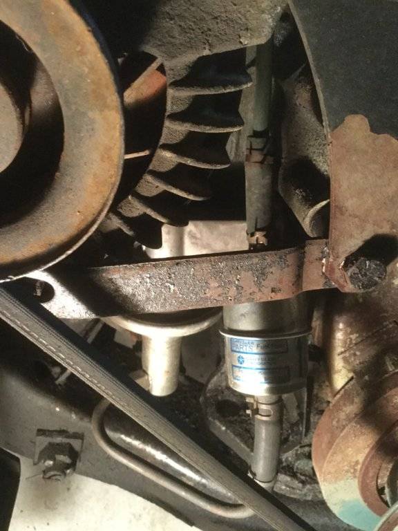

Thank you for the extra photos. My fuel pump has a nipple and 3/8 rubber hose attached to it. Maybe I will just have to get creative.
The hard lines run about $25 for both.
I don't like rubber fuel line on top of my hot engine.
Although I get the sense that most people don't like them I did like have the clear fuel filter so I could see that there was gas getting thru.
agreed i used to run glass filters on all my cars so i could see fuel levels, until my friend burnt up a T/A because his the little rubber 0 ring gave up on one side and hot fuel all over everything the top of the motor double plus ungood.

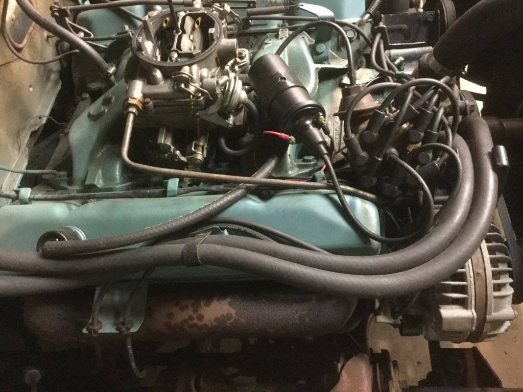

I have a related routing issue with Snow White, my '70 N-code Polara 'vert: the fuel line from the pump to the carb is not just incorrect, I am also not comfortable with the location. I would like to go back to original. Van's has lines for a '67-'72 A- or B-body or a '70-'71 E-body 383 and for '67-'72 400 and 440 on A- and B-bodies, but it's not clear to me whether either would work for a C-body.
@detmatt, @saforwardlook, @CBODY67 and anyone else with prior experience here, I am all ears for a supplier suggestion. The carb on my car is a Carter AVS 4734S that has just been rebuilt by @Dana. Here are a few pictures that @71Polara383 took.
@Cags70PolaraConvert -- did you get new fuel lines?
The Van's descriptor doesn't really help for a C body vehicle. What matters for a C body is whether you have an Carter (AVS or Thermoquad) or a Holley on your application. For your N code Polara, the correct line in their offerings would be for a Carter AVS:
FUEL LINE PUMP TO CARB 1967-1972 A, 1970-1971 E-BODY 383 CARTER AVS CHZLNE003
Van's descriptors of what someone would need even for A, B, and E bodies seems suspect to me and isn't as simple as they seem to suggest - there was more complexity than they as acknowledging I believe, but for you, the choice is clear.
